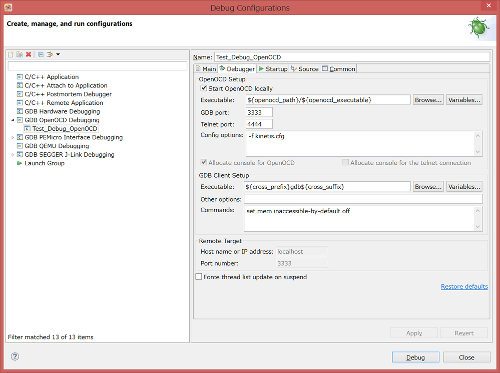

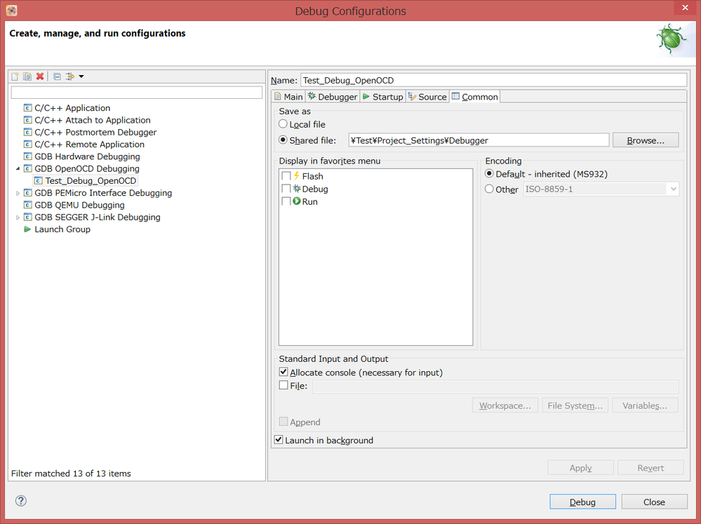

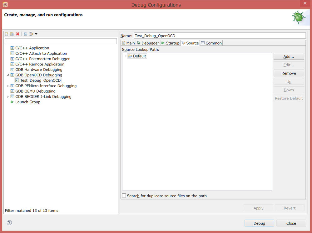

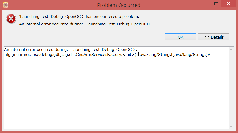

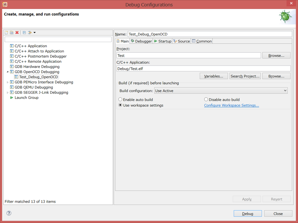

Hi all,
I'm developping my software for FRDM-K64F.
I can debug using OpenOCD by KDS3.0 on Windows7(32bit).
But I can't launch OpenOCD by KDS3.0 on Windows8.1(64bit)
When I launched OpenOCD, I got pop up message below.
These images are debug config windows.
79625_79625.pngconfig1.png79626_79626.pngconfig2.png79627_79627.pngconfig3.png79628_79628.pngconfig4.png79629_79629.pngconfig5.png
I don't know how should I do.
If you have any advices, please let me know.
Kiyoshi

Hi Kiyoshi,
While your Multilink arrives you could use the P&E OpenSDA interface, please take a look to the step 2 of the following document, it explains how to update the firmware of your board from OpenOCD to the P&E OpenSDA firmware and how to set KDS to debug using it:
https://community.freescale.com/servlet/JiveServlet/download/105199-4-294696/Summary%20of%20FRDM-K64...
Hope it helps!

Hi All
Same error here after fresh install on Windows 8.1 (64bit). I have also try on Windows 10 (64bit) and get same error but don't have any near Win 32bit to test it... Workaround from Carlos works for me but I don't want to use OpenSDAv2/P&E Micro, I would like to use OpenSDAv2.1/mbed CMSIS-DAP.
Did someone found solution on that problem?
thenks
Ervin

kiyoshimatsuzak
Hi, Carlos
I could debug by P&E OpenSDA interface on Windows8.1(64bit).
Thanks a lot!
Kiyoshi
2,944 Views
kiyoshimatsuzak
Hi, Carlos
I'm sorry my reply is late.
I got PEMicro's Multilink and I could debug on Windows8.1(64bit) using it.
I'll try your suggestion later.
Thank you so much!
