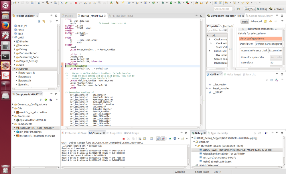

hi, guys. I'm begginer in freescale.
actually, I didn't even know that what the problem is in this code.
I think that is default handler.
when I was coding for uart driver I got a problem about default handler.
Maybe I know that picture of bottom is occured exception and next bottom is main code.
I already got many solutions for this issue on this community. but, I couldn't do that
I guess that issue is related Clock Gating.. whatever
this board is FRDM-K64F
nobody know that issue... TT so, if anybody know that problem.... help me...
thank you.
Noah.

Hello noah,

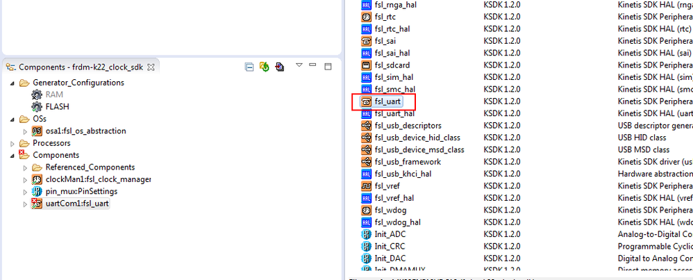

(1) Form your picture , i see you use KDS and  KSDK,  please tell me the version of KDS and SDK .
(2) IN you code, i see when initialize the UART component , you sue the code by yourself , and in the KSDK driver , there have
UART_DRV_Init , you can directly use , and under the SDK install directory , there are some UART demo , you can refer to :
...Freescale\KSDK_1.2.0\examples\frdmk64f\driver_examples\uart
(3) Also you can use the Processor Expert , directly add UART component , then configure , then it can generate code
(4) If you still want to know why is wrong about your code , please send your project to me , i will test it on my side .
