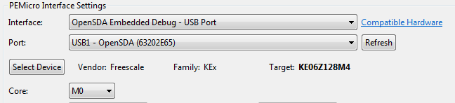

I'm trying to use 2 KDS on same machine, to develop a CANbus network.
I've 2 FRDM-KE06Z boards, configured 2 workspaces.
The started both KDS, each in a workspace.
Then i configured first KDS to debug with one of the KE06Z boards, configured on debug configurations, start, all right:

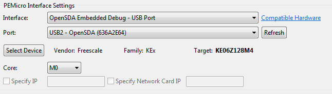

Then i changed to another KDS instance, configured debug to the another KE06Z board:

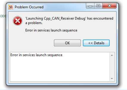

Each debug separately is working, but, when i tryed to debug one, and then debug another, i got this error:
I'm missing some configuration?

I have tried and failed when having two KDS sessions opened to debug two Freedom boards as well.
My workaround is to have one Freedom board use PEMicro OpenSDA and the other board to use Segger JLink firmware.
David
1,562 Views
BlackNight
I'm able to debug multiple boards in parallel with the Segger firmware, see Debug Multiple Boards with GDB at the Same Time | MCU on Eclipse
I have not yet able to do the same with the P&E Multilink/OpenSDA firmware.
