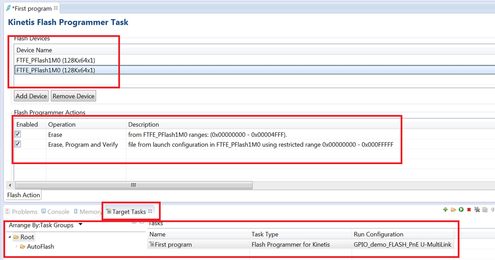

My customer mitsubishi is using KV5X and KDS, they want to know how to download several program sections into different address in KDS(no need to debug). Before they use CW, they use target task to download several program sections into different address like below,as it can assign the offset address. but i didn't find such function in KDS, is there any other method to achieve this target. thanks.

There isn't the "Target Tasks" function in KDS.
While there is a method about protect some areas when flashing program,
please review this post to check whether it can work for you :
Updated P&E GDB Server for Eclipse: Connect/Attach and Advanced Flash Programming | MCU on Eclipse
