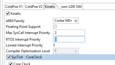

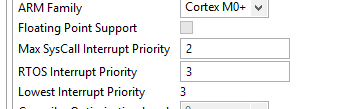

Thanks Erich for all the help.  The problem is definitely the interrupt level scheme, which seems a little confusing to me, but I made the OS be level 3, and all components which are ISR's and signal the OS be level 2.  This now works, as these were set at level 1 which is a crash situation.
The OS settings:
An EINT component setting:
I also used the latest component from GIT (FreeRTOS v8.2.0)
Hopefully other users may find this thread useful is they choose to run FreeRTOS on the Cortex-M0 Freescale processor...
8,801 Views
BlackNight
Now your settings look ok, with the RTOS running at the lowest level (3), and ISR's which do calls to the OS are up to level 2 max (Max SysCall Interrupt Prio). Indeed, if you have in your above configurations interrupts with level <2 (numerically lower) and calling OS functions, this will corrupt the OS, as outlined on FreeRTOS.org.

What should the RTOS Interrupt Priority be set to?
I have this setting:
but I am still getting the data corruption.  I turned off the tickless idle, but nothing seems to help.

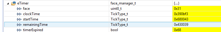

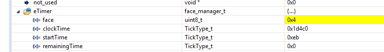

To give you a sense of what I am seeing here is the watch output of the task variable on the first pass
The task goes back to a blocked state waiting for the next message:
As you can see the variable has gotten clobbered, the values should not have changed.  uxTaskGetStackHighWaterMark( NULL ) returns 204, so plenty of stack left.
8,801 Views
