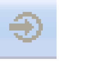

Without open another post, where i can find this botton in KDS for reset the micro? i'm using USBDM. Thanks
3,075 Views
BlackNight
Unfortunately, there is no such thing (hardware reset) with GDB. And as KDS is using GDB, this does not exist.
What you have is 'reset and restart', but no 'reset only':
