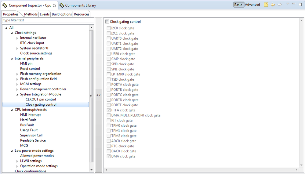

Hi Peter,
for KL25Z with LDD components, you can find clock gating in a processor component, Internal peripherals > System Integration Modules > Clock gating control:
The code is then placed into PE_low_level_init() function called during application startup.
In case of Processor Expert with Kinetis SDK there is System Integration Module initialization component, Init_SIM, where similar properties are available and code placed in the Init() function of this component.

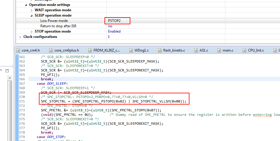

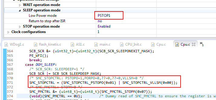

Hello Peter,
Yes, the PE generate the code :
when you select the "STOP2" mode, you can see the generated code :
when you select "STOP1" mode , you can see :
And in stop1 mode , from the Reference manual : PSTOP1 - Partial Stop with both system and bus clocks disabled
so , i thin it can not use ADC .
Hope it helps
Alice

Hello Peter,
I suppose that you want to configure clock gate during execution of your application (before entering the partial stop mode).
The run-time settings of peripherals clock gates can be configured by using SIM PDD macros (see SIM_PDD.h source code file, SIM_PDD_SetClockGate() macro) when you are using Processor Expert project without Kinetis SDK.
If you are using Kinetis SDK you can use fsl_sim_hal component and SIM_HAL_EnableClock() and SIM_HAL_Disable() function of this HAL component.
Please note that you must prevent access to a device's registers when you disable the clock gate of the device. Otherwise the hard fault exception will be invoked.

petertwiss
Lucas & Marek,
Thanks for your reply. I found these options under the CPU component properties, using your picture, but I am using the typical view
For others who may use this:
- Go to your CPU component Inspector
- Go to Internal Peripherals Tab
- Go to System Integration Module Sub-Tab
- Go to Clock gating sub-sub tab (haha)
- Enable clock Gating and which peripheral.
Thank you Marek & Lucas!
-Peter
