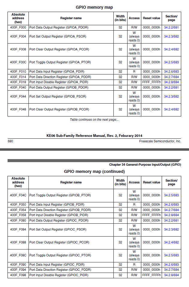

I created new project with KE06 in kinetis design studio.I tried PDD or BitsIO_LDD, GPIO_LDD components, but I have only GPIOA, GPIOB and GPIOC, other ports are missing. I don´t know if it is mistake in my setting or some bug in KDS.Thank you for your opinions.

per KE06 reference manual GPIO memory map, it only has GPIOA, GPIOB and GPIOC. No other ports on chip.

Thank you, it has PORT Pins A,B,C,D in GPIOA register, PORT Pins E,F,G,H in GPIOB and PORT Pins I in GPIOC. I thought that it has one GPIO register for each PORT as KL25 which has five PORT and five GPIO registers.
