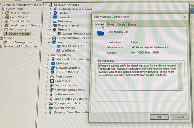

Using KDS, when I setup flash from file, and get to debugger section, selecting USB Multilink, USB Multilink FX, Embedded OSBDM/OSJTAG as my interface, and click refresh, the USB Port does not come up.
DebuggerDebugger
When I check Device manager, this is what i receive:

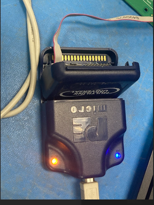

Below is the Programmer I'm using.
Please advise.

HI lstrattan,
Your second picture shows the device not correctly recognized.
Please download USB Multilink Resources Install from this url
https://www.pemicro.com/products/product_viewDetails.cfm?product_id=15320180&productTab=1000000.
This package contains PEFirmwareConfig.exe utility, technical summaries, up-to-date firmware, and other resources.
Using this tool to update P&E multilink FX firmware and install the up-to-date firmware. See how it works.
I would also suggest you chanage another PC can USB cable to isolate influence of other possiable factors
