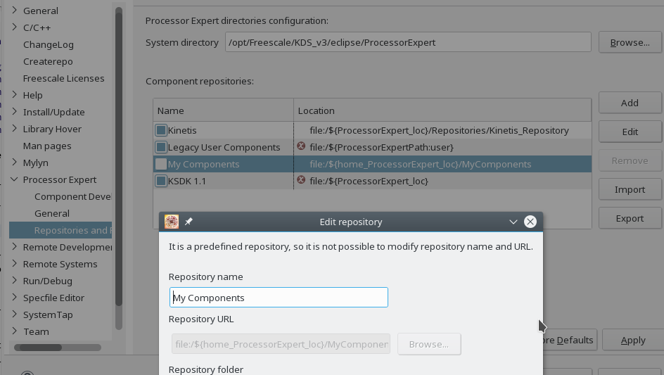

There is a setting here:
At least for the 'MyComponents'.

arjunnair
Hi Erich,
Thanks. Unfortunately, that doesn't help. It isn't possible to edit the path.
