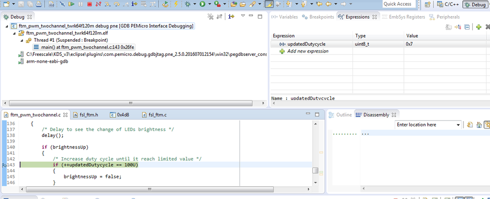

Could you share your screen to get what you get when you use Expressions tab? the expression will be updated only when you have your debug session paused, for example if you put a breakpoint, and also the variable need to be in the scope of the program. for example:

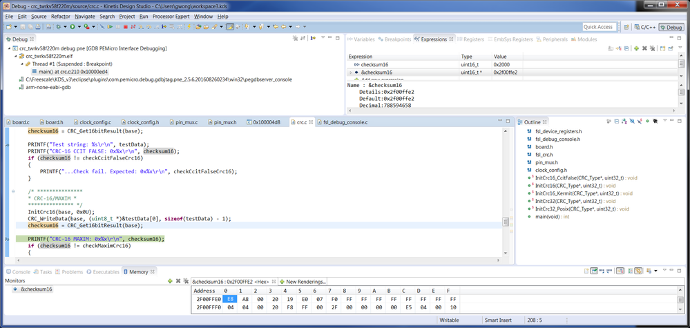

gregoryw
Ah there we go. Thank you.
Are you referring to this screen?

gregoryw
Thanks so much Jorge,
It behaves like this no matter what project I use or variable I choose to monitor.
I have Exported the project as a zip file here:

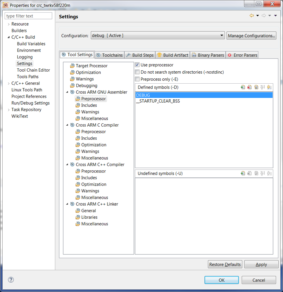

jorge_a_vazquez
Hi Gregory,
Do you have any compilation setting in the build options???

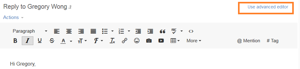

I can't open the link, it said {"success":false,"error":404,"message":"Not Found"} . You can attached documents in .zip if you use advanced editor:
