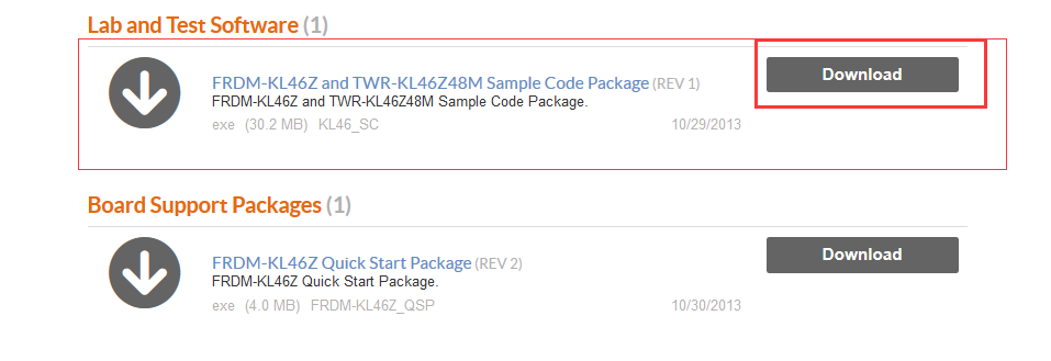

-If the ADXL335 work well , there is ADC demo you can refer the code compare with your code :
FRDM-KL46Z|Freedom Development Platform|Kinetis MCU|NXP
After download and install it, you can find the ADC demo :
kinetis_kl46_sc\kinetis_kl46_sc_rev2\klxx-sc-baremetal\src\projects\adc_demo

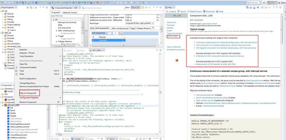

- Also on the KDS, if you create one Processor Expert project, there is also ADC demo :
Hope it helps!

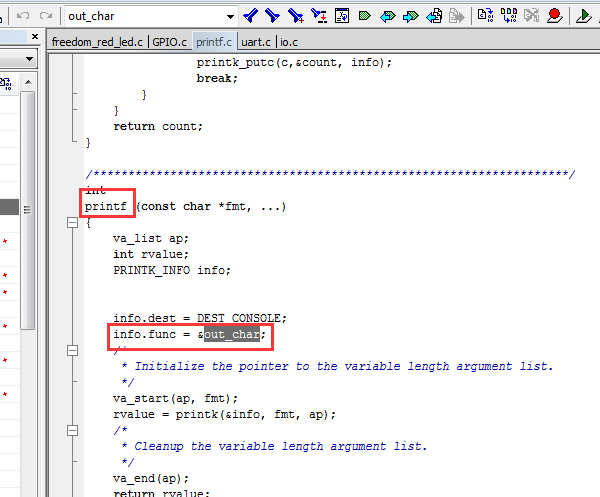

BTW, I observed the printf() function in demo code, however I removed it and used uart to print on my PC instead. How can I use the printf() in the demo code please?

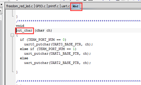

Hello Shaocheng,
Do you meaning the demo under kinetis_kl46_sc ?
If yes,  the demos use the UART to printf . Yon can find the printf function in the file of "printf.c",
then you can step into check using which UART:

About the Processor Expert  , there is a User Guide in the attachment ,  i recommend you first
read the Chapter4 , it show how to create PE project . Then you can refer to the demo code i mentioned
last time .
