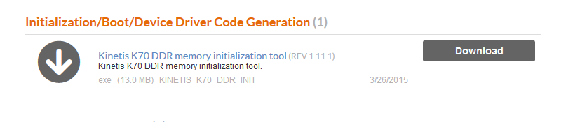

-  There also the DDR memory initialization tool : K70_120 |Kinetis K70 120/150 MHz MCUs|NXP
