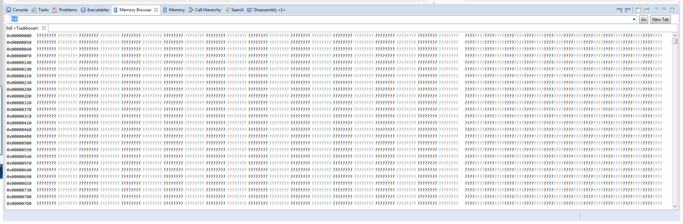

I'm using:
Kinetis Design Studio 3.2.0
FRDM-K22F board (embedded GDB SEGGER J-Link debug connection)
I can load, execute, hit breakpoints, source step and even view variables and expressions, but when I try to look at the memory browser or EmbSys Register view, the console reports:
"WARNING: Failed to read memory @ address 0xyyyyyyyy"
help!
P.S. Disassembly window seems to work ok, just not memory...maybe the problem is only RAM access? weird...

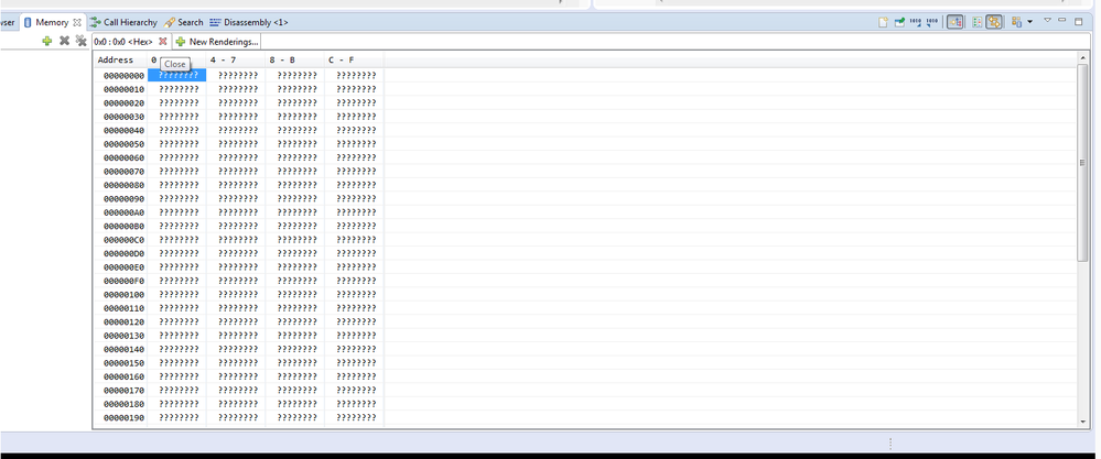

Hello Dave,
On the EmbSysRegView, have you select your chip :
About the memory , could you please take a screenshot about it , have you use this Memory view ?
Hope it helps
Alice
2,962 次查看
jdavid75
Hi Alice,
For the EmbSys Registers, yes I did select the device name.  The problem appears to be that reading from target memory in general doesn't work, so since the registers are memory-mapped they also don't work.  Here is a screen shot of my memory browser window:
Here's a shot of my memory window:
Here is a dump of my console window while I was looking at the memory windows and the disassembly window.  You'll notice that the disassembly memory reads work - may because flash reads are working but RAM reads are not?

2,962 次查看
Hello Dave,
How about this  question , have it be resolved ?
IF still can not , you  can use the J-link commander to erase all(use the command "unlock kinetis"), then load project
to have  a try .
Hope it helps
Alice
2,962 次查看
jdavid75
Yes this is resolved, thank you.
2,962 次查看
Hello Dave,
What about your project,  could you please test one simple project , for example only create one K22
project ,not add other code .
Alice
