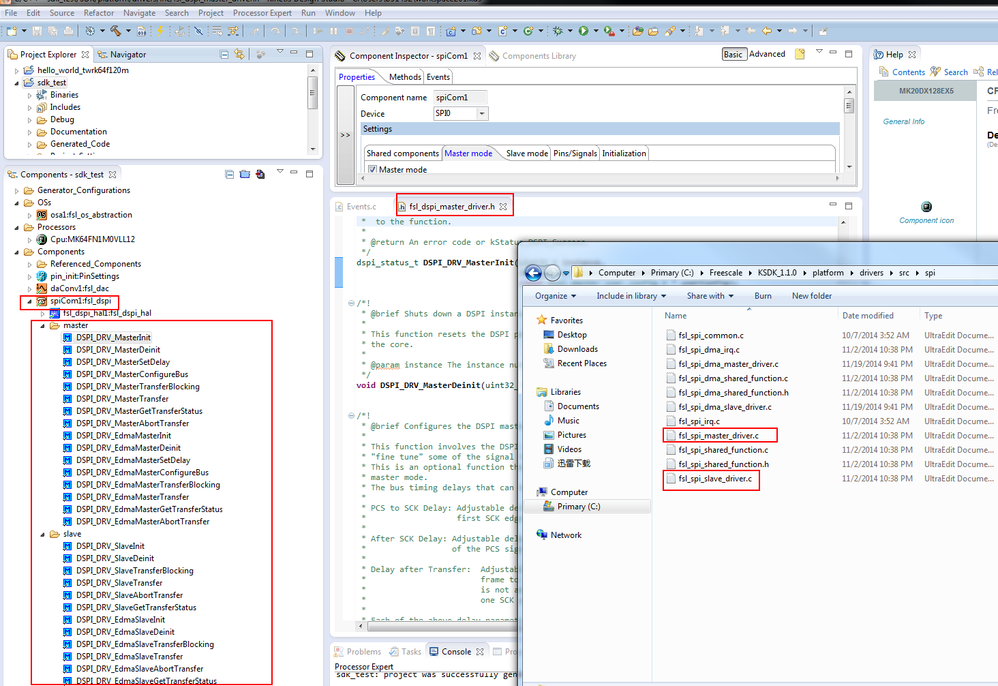

Hi Ole,
You can find the SPI interface function under the SPI component , and in the file of "fsl_dspi_master_driver.h" / "fsl_dspi_slave_driver.h" and so on .
Please see the screenshot below :
Hope it helps

Well you put me on the track, there is a very significant 'd' which does all the difference.
I have included the fsl_spi_master_driver.h where the correct is fsl_dspi_master_driver.h(!)
If I may suggest a change it will be that the API documentation tells which file to include...
