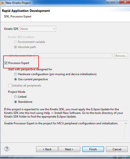

Hello Luigi,
The chip of "MK61Fx512"  is 512 flash , why do you use the 1M flash ?
The attach project is about one timer interrupt project ,
- The one of "k61fx512_isr_nope_isr" is about bare board project , when you run it , you can see the
variable of "testcnt" increased :
- The project of "MK61Fx512_isr_test" is one project with Processor Expert (PE), the PE
project is when you create project select this :
Alice Yang
