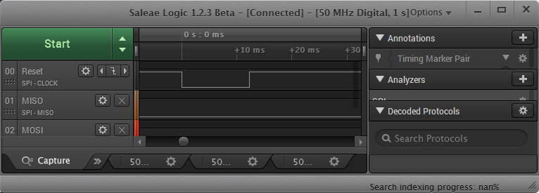

BlackNight
Hi Salvatore,
I quickly tried the same with KDS V3.x and the P&E Multilink Universal, and I can confirm it toggles the reset pin automatically (no need for a setting):
I hope this helps,
Erich

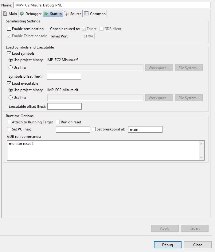

Salva
Hi Erich thanks for your response. I tried your suggestion and it works !!
Only a couple of informations:
1) my KDS (3.1.0) / SDK (1.3.0) is for K64. It looks slightly different and you have to set the command "monitor reset 2" in a different position. Then here is no need to set the "2" on "type" box (also because it is not here ;-) ).
It looks like this:

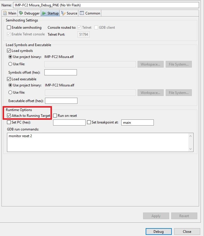

2) Into "attach" mode it doesn't work. But the funny thing is that the "restart button" doesn't work at all: it doesn't change the PC !!
Of course it doesn't work also without "monitor reset 2" command.
Here the "attach" setting (that doen't work !!!):

BlackNight
Salvatore,
my screenshots are for Segger J-Link, yours are for P&E. They are different. And they behave differently as they have different GDB server implementations. I believe the P&E reset command does not support that additional argument (I think it is ignored).
Erich

Salva
OK Erich I understood the different screens from Segger & Multilink. I only posted the different screens to help other people using P&E Multilink ;-).
I confirm that it works also on my application giving an hardware reset.
What about the "attach problem" I mentioned ? Have you the same behavior (restart button does nothing) on Segger ?
I think this could be a KDS/GDB  problem.
