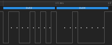

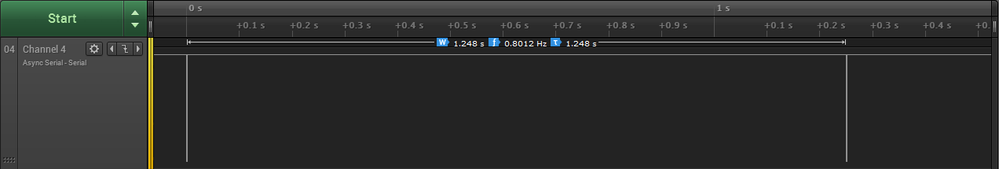

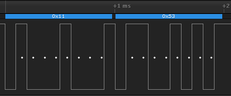

I'm experiencing some bizarre behavior from my KL15 microcontroller. When attempting to send 6 bytes continuously, my UART channel instead sends 2 bytes before stalling, or stuttering, before sending the next consecutive byte and then immediately restarting from the beginning of the message sequence. Oddly, the UART waits until the sending function is again called (once every second through a routine in the main RTOS structure) before sending the byte that I had previously instructed it to send, although by that time a new byte should have been loaded into the buffer. Here is a Saleae analysis of the problem:
Note how the blips on the top image are each two bytes, spaced about one second apart. The middle image is the first two bytes, and the bottom image, the last two. The message that I am trying to send is:
     0x53     0x04     0x11     0x11     0x00     0x03
Which should be repeating every second. Instead, as you can see, the first message begins to transmit the first two bytes correctly, but then is cut short. The next subsequent byte inexplicably winds up being sent a second later.
