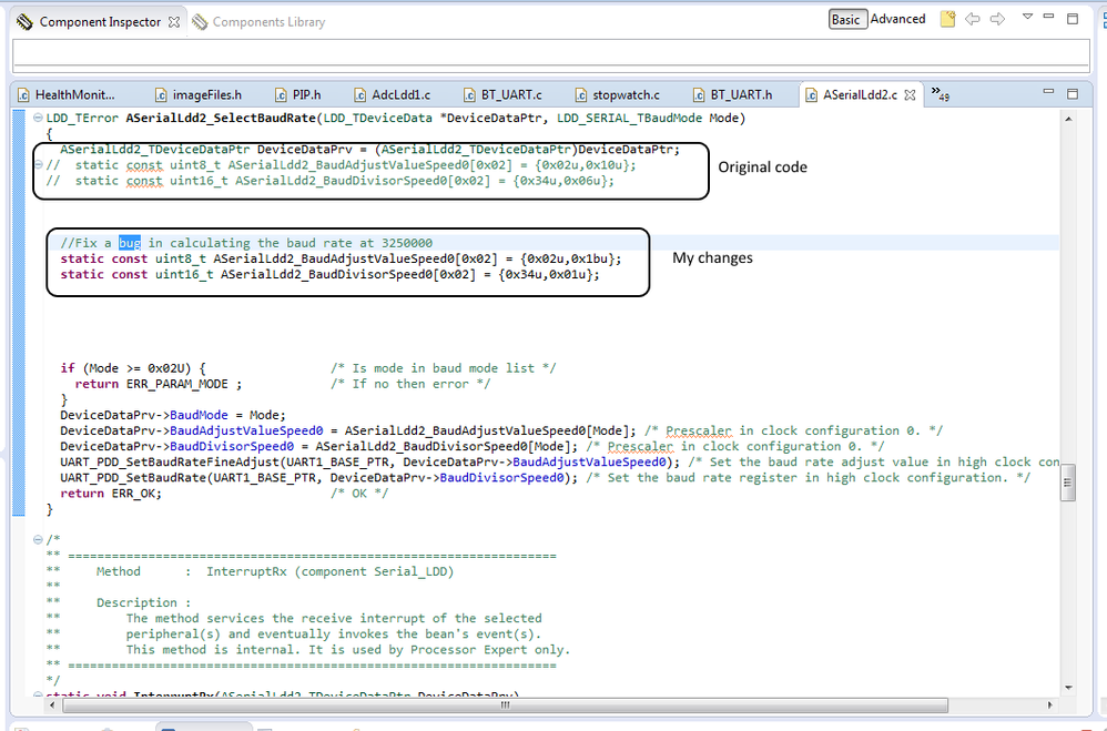

I had to set up uart with 2 modes of operation, one in 115200bps and one in higher baud rate.
When I’ve set the second mode to be 921600bps, it was working fine, but when I set it to be 3250000bps, the transmission was actually at ~900kbs instead.
Found out in file ASerialLdd2.c
in function ASerialLdd2_SelectBaudRate there
is an array holding the possible values for register UART2_C4 field BRFA and registers UART2_BDH and UART2_BDL
BD is holding the baudrate divider and BRFA is holding the fine adjustment value.
The calculation is
Baudrate = UART
device clock/(16*(BD+BRFA/32)) = 96MHz/(16*(BD+BRFA/32))
The original lines were
static const uint8_t ASerialLdd2_BaudAdjustValueSpeed0[0x02] = {0x02u,0x10u};
static const uint16_t ASerialLdd2_BaudDivisorSpeed0[0x02] = {0x34u,0x06u};
This gave ~900Kbps to mode 1
The modified lines are
static const uint8_t ASerialLdd2_BaudAdjustValueSpeed0[0x02] = {0x02u,0x1bu};
static const uint16_t ASerialLdd2_BaudDivisorSpeed0[0x02] = {0x34u,0x01u};
This gives 3250000bps to mode 1 (as intendant)
Why is that?

Hi Alice.
This is the code snippet I have
I am using two different baud rates in different mode. I don't think you've setup the UART the same

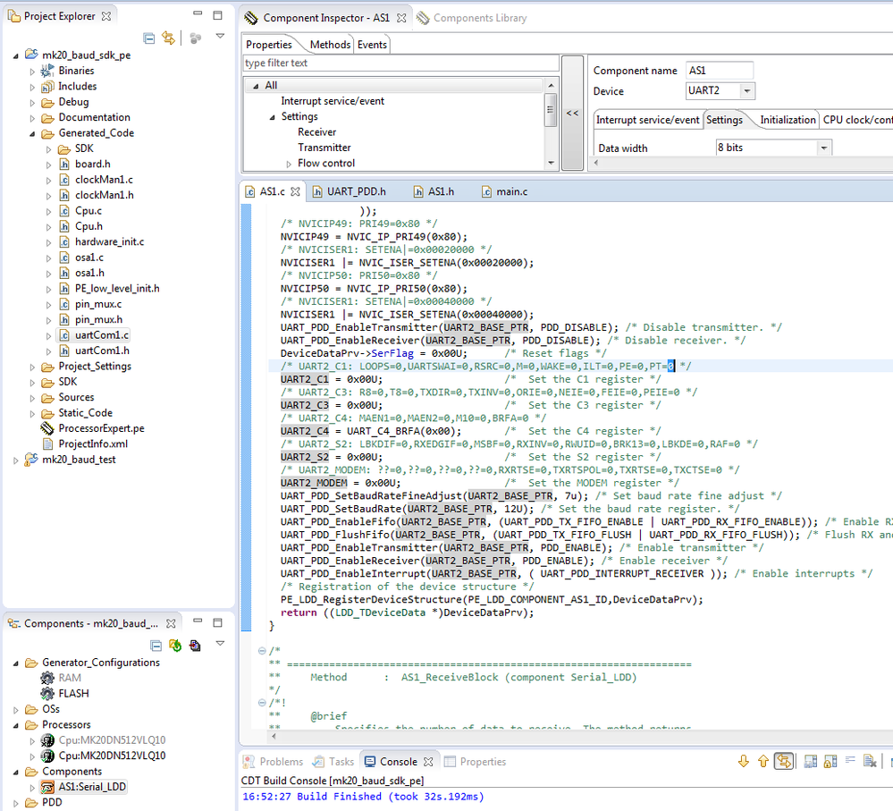

Hello Zohar,
Are you sure the code you shown is generated by PE ?
On my side , i also create one project , then add the UART component ,
while i have not find the code you side , could you send your project to me ?
On my side , it is like this :
Alice
