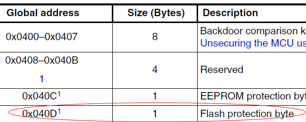

Now, I need to save this configuration in the flash so that I do not need to reconfigure FPROT register every time at startup.
When I searched for this topic, I've seen that the protection configuration can be programmed in address 0x40D so that just after reset, the needed configuration for the protection will be loaded in FPROT register automatically from address 0x40D.
MY ISSUE is here; I could not do the programming of this byte in the flash (I.e. address 0x40D).
When I write the configuration of FPROT register, data has not been transferred to address 0x40D which means it has not been programmed so I don't know how to program it in address 0x40D after writing this register (FPROT).

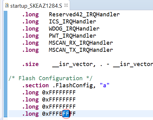

 - If you want to configure Flash Protection Register "FTMRH_FPROT", directly config address 0x40D ,
During the reset sequence, the FPROT register is loaded with the contents of the flash
protection byte in the flash configuration field at global address 0x40D located in flash
memory.
In KDS project, configure it in startup file :

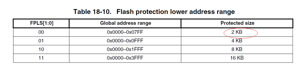

-  The smallest size of protection is 2K in KEAZN64, not 512 bytes.
About how to config, please check the register of FTMRH_FPROT.
