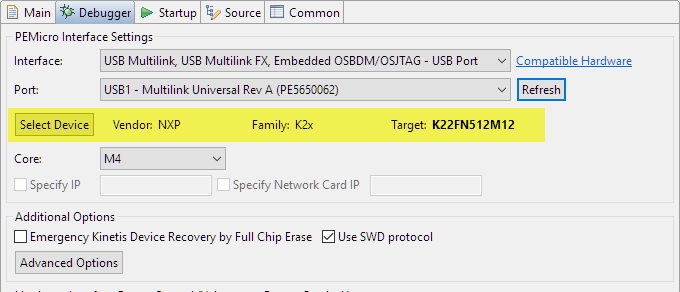

Hi Nico,
In the debug configuration, check that you have selected your device:
I hope this helps,
Erich
