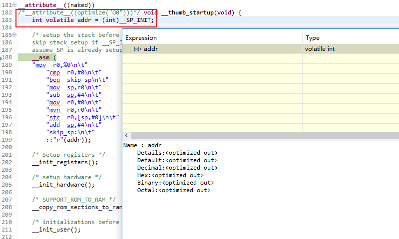

And the second one is that, when compiled with O2, I found a locale variable is optimized out which used in asm instructions. So, my question is that, how to avoid this in ALL of source files generated by Processor Export?

The local variable optimized away when I removed the __attribute__(optimze("O0"))
As compare, I remove the comment, and it display as following
7,314 Views
BlackNight
That's normal and expected with higher optimization settings. If you want to keep it, the usual way is to define the variable with 'volatile'.

vaughn
hi Erich, I found local variable will optimized away even if volatile added, and GCC's version is arm-none-eabi-gcc 4.9.3.

BlackNight
you would have to mark the cpuSR as volatile.
7,314 Views
vaughn
Erich, no effect even if volatile added, so you can try it with compile option -O2 and linked with LTO
7,314 Views
BlackNight
I have documented how I have been fixing that warning message caused by -flto in GNU Link Time Optimization finds non-matching Declarations | MCU on Eclipse

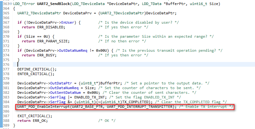

And the second question is that, are there bugs similar with optimized away within other modules generated by PE, e.g. UART, MSCAN, SPI. For I found another problem using UART, which runing ok with O0 compile option, and run to UnhandledInterrupt when UART transmit.

vaughn
when compiled with O2 and LTO, when run to UART_PDD_EnableInterrupt and continue, it run to UnhandledInterrupt, but i can not location the problem accuratly.
the UART source files attached.
7,311 Views
BlackNight
To know which interrupt is causing this, turn on 'one for every', see Oh my! An Interrupt… | MCU on Eclipse
