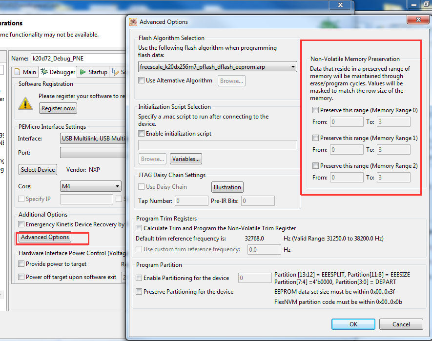

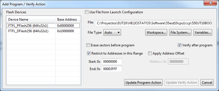

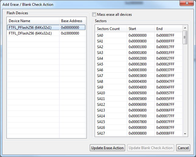

Hi all,
I wonder if it is any tool or option in KDS similar to target task in CW.
I am developing a bootloader and want to load the app without deleting the boot.
How could i delete a certain bunch of addresses leaving the rest of them as they were.
Any help will be appreciated.
Thanks and best regards
2,158 Views
DavidS
2,158 Views
Hello Alberto,
Yes, refer to the tutorial David suggest above , configure the Memory Preservation
to preserved range of memory maintained through erase/program .
Hope it helps
Alice

DavidS
Hi Alberto,
Please review this post to see if it works for you.
https://mcuoneclipse.com/2015/04/16/updated-pe-gdb-server-for-eclipse-connectattach-and-advanced-fla...
David
