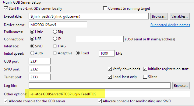

Would like to have 2 K22's in one jtag chain. It appears segger j-link supports this, but was wondering how this would be supported/selected in KDS before implementing such a board design. Does KDS have support as far as selecting which processor to program and debug in the jtag chain?
1 解答
4,698 次查看
BlackNight
Hi George,
you can pass the options to the GDB server here:
Erich

Hi George,
that link Alice has provided deals with multiple parallel debug connections. But what you want is to have multiple devices on the same JTAG chain. I have not done this, but the SEGGER J-Link reference manual (UM08001_JLink.pdf) provides information about the how you have to deal with multiple devices on the scan chain (search for "multiple devices in the scan chain). You can pass this information through the SEGGER J-Link debug launch configuration in Eclipse.
I hope this helps,
Erich

BlackNight
Hi George,
Erich

gsosnow
Hi Erich,
Thanks, this should work with passing the option: -jtagconf
George
