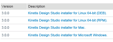

When I attempt to download the KDS, I only have options for the installer.
3,144 Views
BlackNight
Click on one of the downloads, it will show the source file package.
