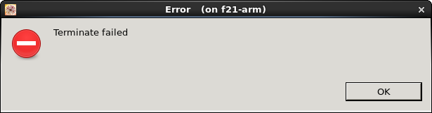

I am running KDS in Linux and can download and debug fine on a frdmk22f, but when I try to terminate the debug session (by clicking Terminate), the debug session does not terminate.  I can not start another debug session unless I close KDS and start it again.

The terminate seems to stop the gdb sessions just fine
While Debug Session is running:
[sbrecheisen@f21-arm ~]$ ps -ef | grep -i gdb
sbreche+  4000  3957  0 10:21 pts/1    00:00:03 /opt/Freescale/KDS_3.0.0/eclipse/../segger/JLinkGDBServerCL -if swd -device MK22FN512xxx12 -endian little -speed 30 -port 2331 -swoport 2332 -telnetport 2333 -vd -ir -localhostonly 1 -s
sbreche+  4020  3957  0 10:21 pts/1    00:00:00 arm-none-eabi-gdb --interpreter=mi2 --nx
sbreche+  4060  3625  0 10:27 pts/7    00:00:00 grep --color=auto -i gdb
After Terminate is initiated:
sbreche+  4086  3625  0 10:29 pts/7    00:00:00 grep --color=auto -i gdb

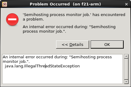

KDS doesn't really give any information about why the terminate fails in the console, but I am attaching the output that I see in the terminal where I launched KDS.

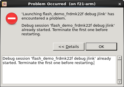

If I go back to the C/C++ perspective and attempt to start a new debug session, I get the following:
I do not know if it is related, but I also always see the following error when I first start my debug session.  But I can still debug just fine, other than the termination issue.  I also attached the output seen in the terminal where I initially launch the debug session  (), although they may not matter.
Attachment: "initial_debug_errors"
Additional attempt to terminate debug session
SemihostingProcess.destroy() Thread[Worker-19,5,main] Thread[Semihosting and SWV fake process,1,]
SemihostingProcess.destroy() after interrupt
SemihostingProcess.destroy() before shutdownInput
SemihostingProcess.destroy() return
