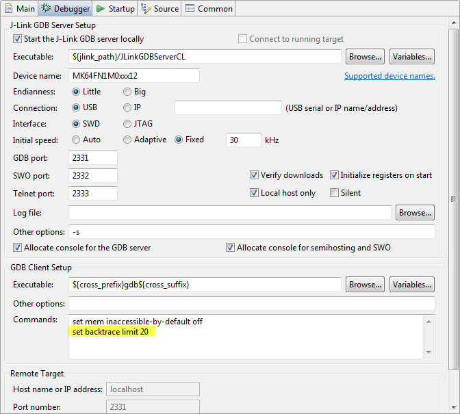

For K22F120M board and MQX4.1 OS,  I found if I set a breakpont in interrupt routine, once this interrupt be trigger, KDS will stop at this breakpoint, but at this time,  any step (step in, step return, step over) will not work,  even 'run' also will not work. the KDS console keep printting like this "Read 2 bytes @ address 0x0000060c (Data = 0xB408)"

Yes, it seems to be a problem with GDB and doing the stack backtrace.
For J-Link, can you add the
set backtrace limit
command with a number like 20 to it? See below. This limits the number of backtraces.
Let me know if this helps.
Erich

The KDS debugger has this kind of error just after  instruction "blx reg",  but at this pointer, I close KDS and open JLink, JLink can connect my K22 board, and "step" command in Jlink is OK, seem this is just a IDE debugger issue.
set backtrace limit
Erich

I have the same issue on the MKL26Z128VFT4, KDS 1.1.1 (Linux), updated processor expert and the latest FreeRTOS. The "set backtrace limit 20" did not help in my case. I can set break points and the program stops at breakpoints; however it does not step into or step over, instead it keeps running. Do you have any other suggestions to solve this issue.
I'm using Segger GDB server to debug.

that number 20 to limit the number of backtraces is arbitrary. Can you try a lower number, say 5 or 3, or even 1?
Erich

Thank you for your prompt responses. Lowering the number of backtraces worked for stepping in main() before starting FreeRTOS tasks. My breakpoints all have 'checkmarks' when in debugging mode. Would it be possible that I send you the project privately instead of posting it here?

GDB "set backtrace limit 20" option  works for debug at MQX ISR environment.
