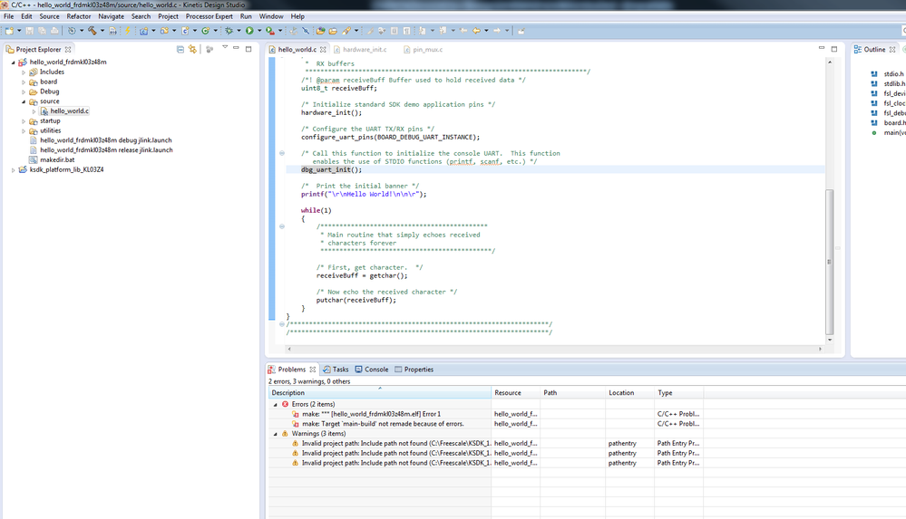

Fan_xy
Hello all,
I also have problem about this.
And I install SDK  and  build the correspond lib refer to related reference manul ,run demo also refer to RM step by step .
While when i build the demo ,it  erros on the screenshot :
Thank you !
Linda

Jorge_Gonzalez
Hello AC:
I don't think the missing paths are causing the problem. Instead the first error indicates that the KL03 KSDK platform library is not built yet, because it cannot find ksdk_platform_lib.a.
From KDS go to File -> Import -> General -> Existing Projects into Workspace and in the next window browse to (C:\Freescale\KSDK_1.0.0-KL03Z\lib\ksdk_platform_lib\kds\KL03Z) to import the library project (:smileyalert: DO NOT check the "Copy projects into workspace" option) and click on "Finish". Then you have to build the library project.
After you built the library, the errors on the demo project should not appear again.
All this is mentioned in the FRDM-KL03 KSDK pdf user's guide in your KSDK installation:
C:\Freescale\KSDK_1.0.0-KL03Z\doc
Also, if you wish to start a new KSDK project after trying the demos, I recommend you to follow the guide in the next link:
https://community.freescale.com/docs/DOC-102612
Regards!,
Jorge Gonzalez
6,968 Views
stefankolody
I have the exact same problem.
I have done all you mentioned including building the library and I can see that file created here:
c:\Freescale\KSDK_1.0.0-KL03Z\lib\ksdk_platform_lib\kds\KL03Z4\Debug\ksdk_platform_lib.a
I still get 2 errors and 3 wanings in hello world demo...I tride some more demos..same thing.
I tried cleaning the projects...no help.
6,968 Views
Jorge_Gonzalez
Hello aeroengineer1, Fan_xy, stefankolody:
Colleague adriancano pointed out that this was caused by the default KDS toolchain. KL03 has only 2 KB of RAM. This issue is mentioned in the KSDK KL03 release notes, Chapter 6 Known issues, from the next link:
http://cache.freescale.com/files/soft_dev_tools/doc/support_info/KSDKKL03RN.pdf
To solve this you have to change the toolchain as mentioned in Appendix B of the FRDM-KL03 KSDK User Guide. This guide can be found in your KSDK installation:
Regards!,
Jorge Gonzalez
6,968 Views

stefankolody
Thank you so much…I was not sure about toolchain swap before..so I skipped it…
Now I installed latest and it compiles….thank you.
3 warnings regarding WDOG are still there
6,963 Views
