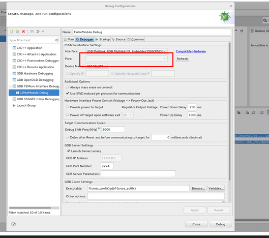

Hello guys, I am currently running KDS 2.0 on Fedora and I am trying to debug our application.  However the debugger does not appear to be detecting the PEMicro multilink. I've installed the "driver" that is on PEMicro website.  After selecting the PEMicro interface and hitting "refresh" a list of connected multilink should have been populated.  I've confirm under dmesg that it is indeed connected.  It shows up under lsusb.  I've installed the driver.
Does anybody have a check list of things to check?  I am new to KDS and the contractor that was working on this project only had it setup on a windows box.
Here's the message I get when I try to debug without a port selected:
P&E GDB Server, Version 5.13.02.00
Copyright 2014, P&E Microcomputer Systems Inc, All rights reserved
Loading library /opt/Freescale/KDS_2.0.0/eclipse/plugins/com.pemicro.debug.gdbjtag.pne_1.1.7.201410171532/lin/gdi/unit_ngs_arm_internal.so ... Done.
Command line arguments: -device=KE04Z128M4 -startserver -singlesession -serverport=7224 -interface=USBMULTILINK -speed=5000 -port= -USE_CYCLONEPRO_RELAYS=0 -FORCE_MASS_ERASE=0
Device selected is ke04z128m4
PE-ERROR: Unable to auto-detect debug hardware. Please specify on the command-line. Halting.

Hello Alice, please note that I have this setup on both a Windows 10 VM and Linux Fedora and I have the same problem on both. I'll send you the screenshot of the Linux environment. I have two chip to debug, the KE04Z128M4 and the mk64fx512vll12 which is the equivalent to the K64FX512M12 in the device name drop down.
I've also attach the screenshot in case it does not show up.
Thanh

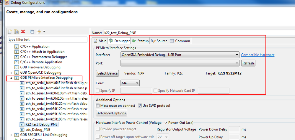

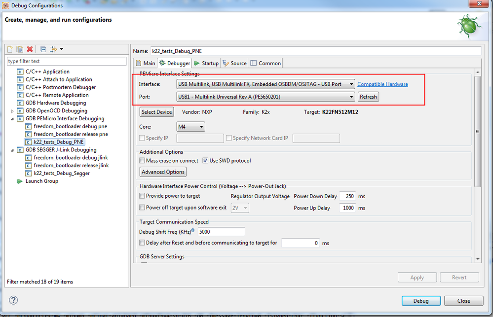

Hello Thanh,
Sorry i have not the Linux system and WIN 10.
While from your screenshot we can see , it have not detect the PE debug port on your board.
Below is the screenshot after i connect the PEMicro multilink to board, and the PC, the KDS shows :
So first i think first you should check whether your PC detect your PE driver , on Win7 it shows :

Hello Alice, I am aware of that the device need to be detected by the OS before you can use it in the IDE. Below is a screenshot of both my Win10 VM and Fedora 22 host. Both show that the the device was detected by the OS, but not showing up under the KDS Debug Configurations Debugger tab under the field Port.
Windows VM:
Fedora:
It's detected by both Fedora and Win10, however KDS does not appear to detect it.
