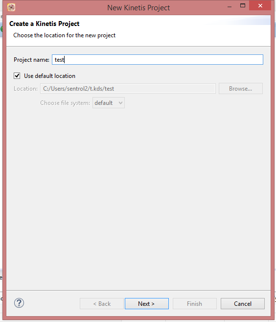

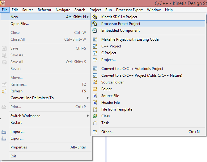

Step 1) go to File >> New >> Processor Expert Project.
Step 2)write project name and click next

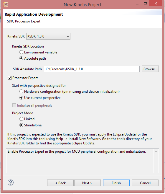

Step 3) write processor number you want, select the desired processor configuration and click next
Step 4) select check box for "Processor Expert" and click finish
