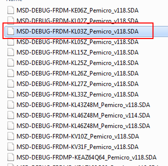

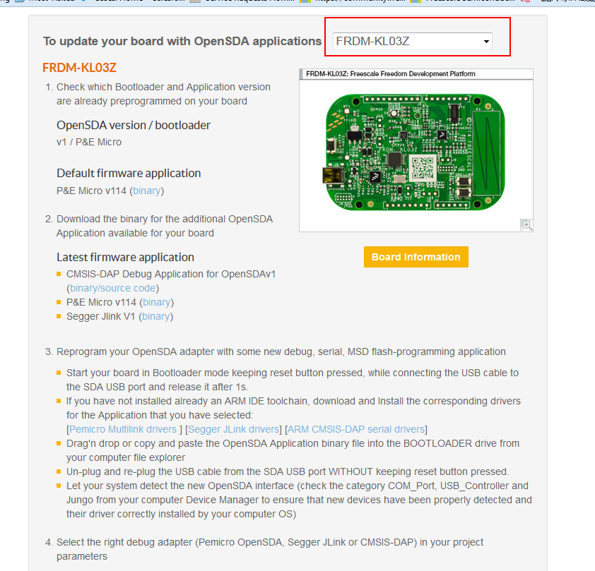

Hello Thomas,
About use which driver to debug , please go to the OpenSDA Serial and debug adapter web
OpenSDA Serial and Debug Adapter|NXP
to check , input your board name , then it will show the result :
After you download the P&E Micro v114(binary) folder , you can find the driver for FRDM-KL03:
Hope it helps
Alice

thomasedel
Greetings Alice:
Thanks for the info.  I'm running ok now with KDS 3.1, PE Micro 11.1.1 driver, and PE Micro v114 firmware.  If I have further problems, I'll try the PE Micro v118 firmware.
