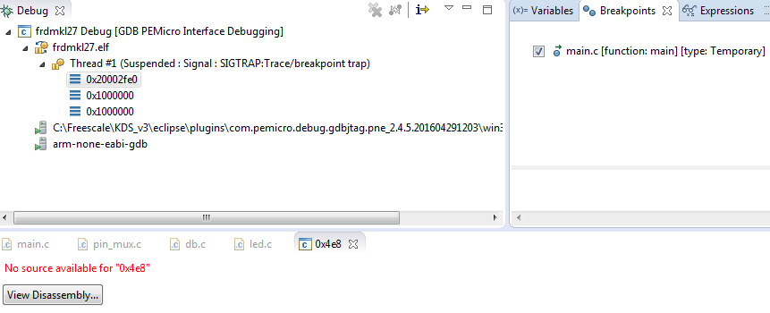

I have run into the exact same problem found in this thread: KDS 3.2 debug mode not working with KL03Z32M4 .
I was using KDS 3.2 with a few different MCUs.  Most recently the FRDM-KL27Z for proof of concept and a KL17 in implementation.
I created a basic app to poll a switch and turn on an LED (that is attached here).  This project uses KSDK 2.0 and the SDA from the FRMD-KL27Z for debugging.  This compiles fine and flashes correctly (with unnecessary NO RESET SCRIPT warning).  Letting the debugger go without any breakpoints causes the SIGTRAP issue:
When the trap occurs the MCU does continue to run and button presses will toggle LEDs.  Once the trap has triggered I can add a break-point in the main loop and after hitting Resume the debugger will reach it, but if the break requires some event to occur the trap will re-trigger.

I had exactly the same problem when I upgraded from KDS 2.0.0 to 3.2.0 with some KL26Z projects.
I upgraded the PEMicro SDA firmware on the board (FRDM-KL26Z) to v118, but that didn't help.
I then upgraded the PEMicro GDB plugin via the Eclipse updater site at:
http://www.pemicro.com/eclipse/updates
There was a newer version there (2.5.9.201609160049) - once that was installed and KDS restarted, the SIGTRAP issue went away.

First the Compiler Preprocessor Defined symbol for both "C" and "C++" was:
"CPU_MKL27Z64VMP4"
and needs to be:
"CPU_MKL27Z64VLH4" for the FRDM-KL27Z.
Second your code seems fine.  It seems the PEMicro debugger does not like debugging at slow frequencies.  In your case 1MHz.  If I left the default frequency then it debugged fine.
Switching to Segger JLink firmware allowed me to debug at the 1MHz clocking.

Toe
Another piece of information that may help here: I'm running in VLPR which sets up the clock to be 2MHz.  If the clock is running full speed (48MHz) this debug issue is not present.
