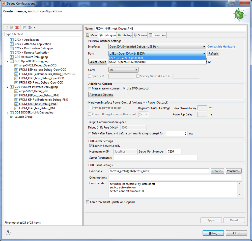

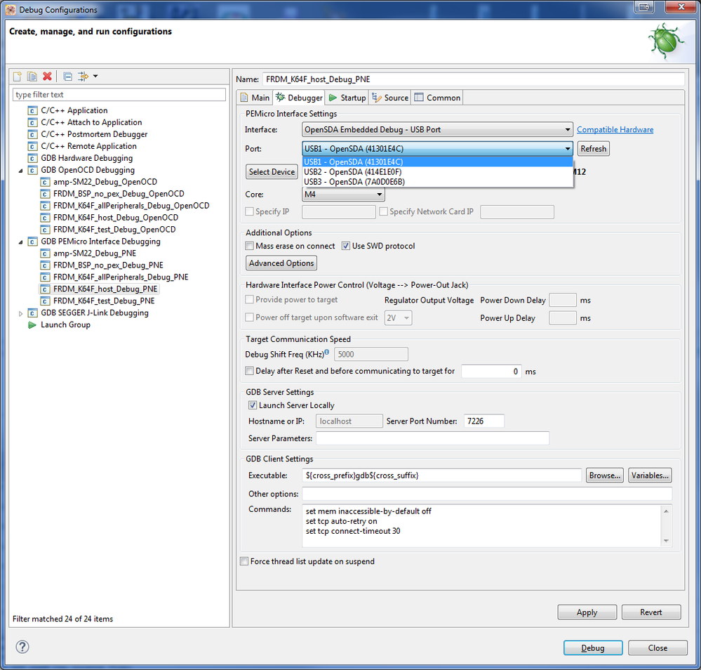

Using KDS 3.1.0 I have been running two KDS sessions to debug two different application.
I have two FRDM-K64F boards talking to each other.
I am using OpenSDA, and DEBUG-FRDM-K64F_Pemicro_v108a_for_OpenSDA_v2.0.bin.
The only thing I needed to do “special” was to set the port numbers differently.
his is in the GDB  PEmicro Interface Debugging” -> “Debug Configurations” in the “Debugger” tab .
In one KDS session it’s 7224, the other: 7226.
After installing KDS 3.2.0 I can debug either the host, or the target, but not both.
When I try to start the debugger on the second instance the programming LED on the board blinks, and then
I get:

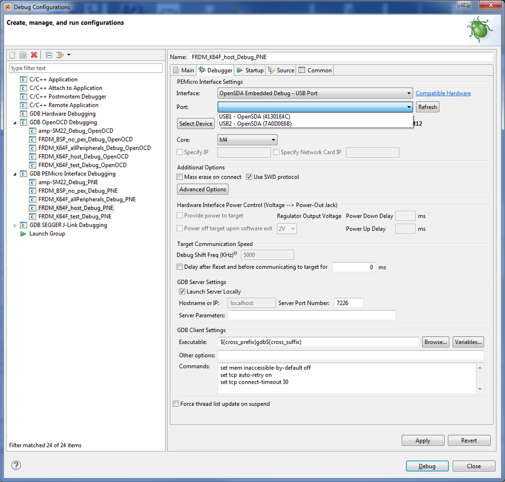

The one thing that I did notice is that the USB indexes are moving around!
Still within a single KDS 3.2.0, when I hook up three boards, I show three debuggers:
If I start the one using USB1 (41301E4C), and try to start another, I get a list again starting with USB1!
Alternately, if I start the one using USB2 (414E1E0F), and try to start another,
  I get a different collapsed list again starting with USB1.
Trying to use either of the remaining USB devices gets me the error.
Also, since the debug config seems to be using the USB number rather than the OpenSDA index, my PE config is changing.

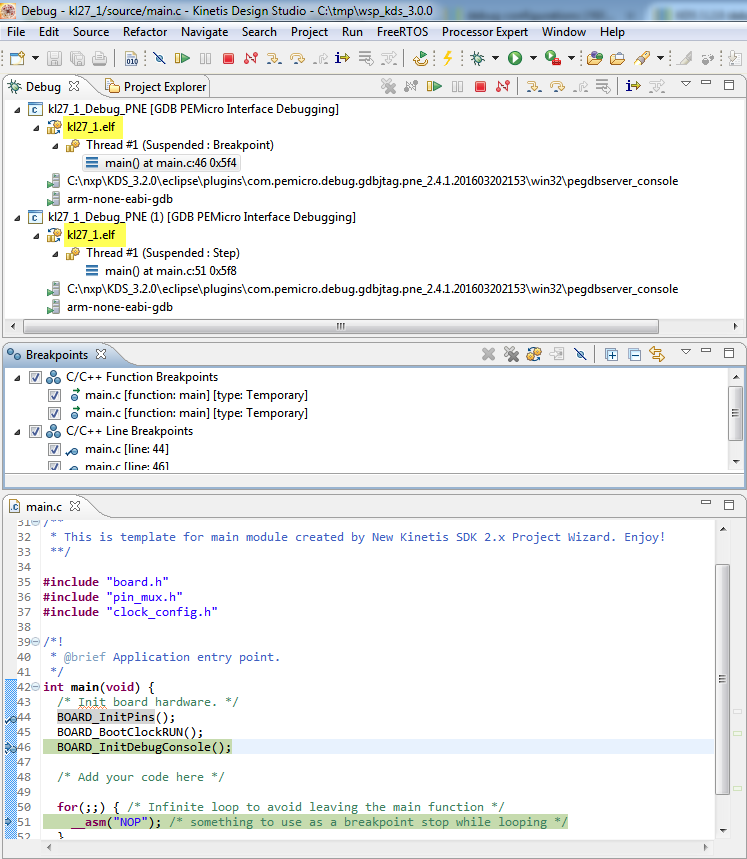

Hi Steve,
>>With your KDS 3.2.0 installation, are you able to open KDS twice, and debug two different projects?
Yes, this has been working all the time for me, in all versions.
What is new that I can now debug multiple targets with the same binary (same project) or with different binaries (different projects), all inside the same IDE.

BlackNight
Hi Steve,
I can debug the same binary (elf file) on two different boards in parallel.
It is true that in this case the breakpoints are 'shared'. You really want to have them separate, I think you would have to debug a  copy of the projects as the breakpoints are file oriented.
Erich

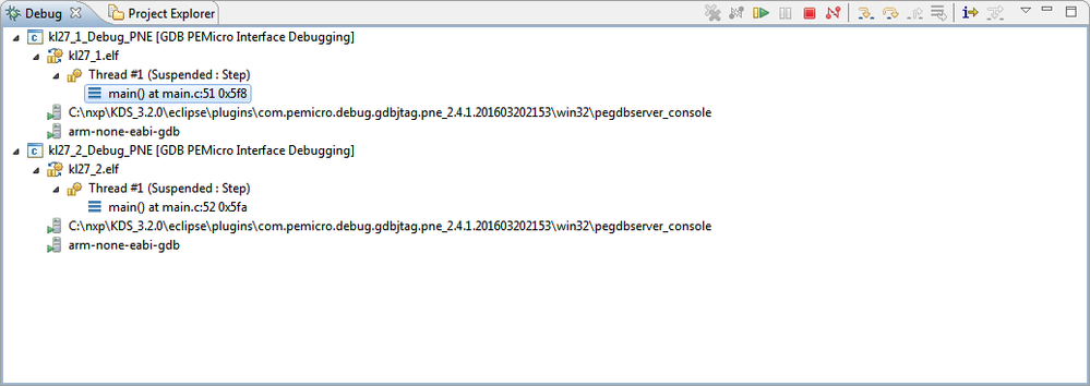

BlackNight
Hi Steve,
I'm able to debug two FRDM boards with P&E OpenSDA on it with KDS v3.2.0, side by side from the same IDE using KDS v3.2.0:
I think I might need to publish an article about that?
Erich

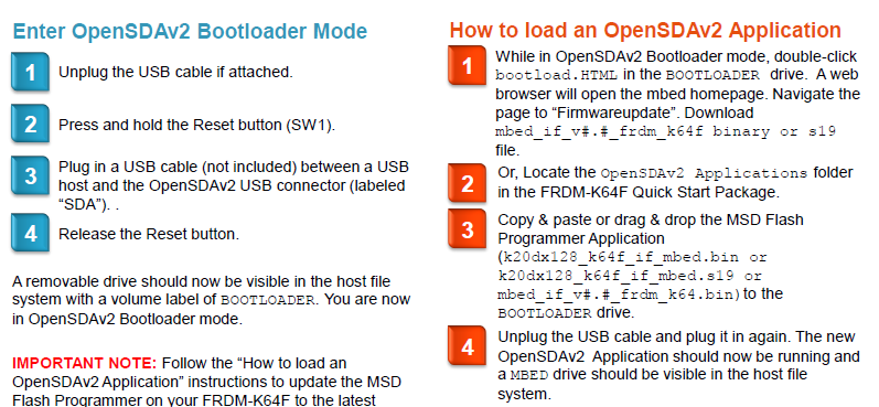

Hello Steve,
I find the DOC Erich write you mentioned.
I also test two board use  GDB  PEmicro Interface  , it is the same with you.
While use the GDB SEGGER J-LINK Debugging , it can work well , so please
change the  board firmware to "JLink_OpenSDA_V2.bin" , then use  GDB SEGGER J-LINK Debugging .
About how to change firmware ,please refer to the "FRDM-K64F Freedom Development Platform -Quick Start Guide.pdf",
pay attention copy & paste the "JLink_OpenSDA_V2.bin"(attachment )
Hope it helps
