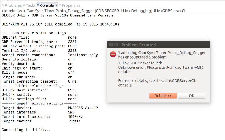

jrychter
Contributor V
Eric, thanks for your help anyway.
For what it's worth, I just installed KDS 3.2.0 on Mac OS X, plugged in the FRDM-K22F with the same JLink_OpenSDA_V2_1_2015-10-13.bin firmware, and got the same error:
J-Link GDB Server failed:
Unknown error. Please use J-Link software v4.96f or later.
For more details, see the JLinkGDBServerCL console.
This Mac never had KDS installed, so this isn't about leftover files.
Has anybody actually tested this configuration? Is this a supported combination?
On a more general note — I use Kinetis processors in my designs, but there is an increasingly troublesome "Kinetis tax". Every couple of months I'm spending considerable time updating KDS or its components, updating the KSDK, learning about the changes, reading the release notes, trying to follow the (sometimes strange) instructions on fixing problems, encountering problems like the one described above, searching the net for solutions, asking questions, detailing configurations, trying out various combinations of files and versions. This engineering time lost is beginning to be noticeable as a considerable cost of using the NXP/Freescale Kinetis line.

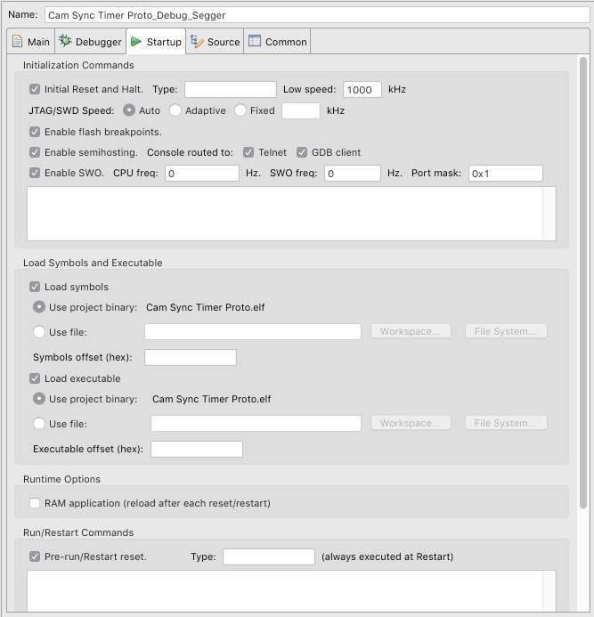

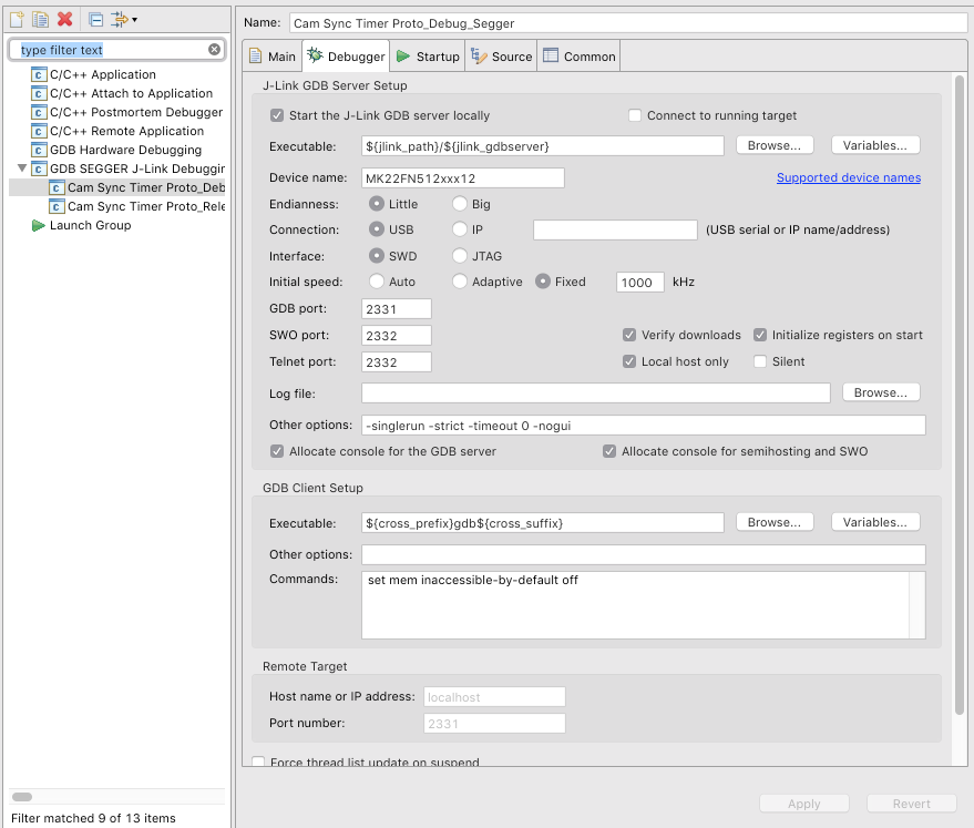

jrychter
Contributor V
That's intriguing — my Mac setup is fresh (just installed KDS for the first time ever, I used to work in Linux under VMware) and should be the default.
I use Mac OS 10.11.4, a freshly installed KDS 3.2, and a FRDM-K22F with JLink_OpenSDA_V2_1_2015-10-13.bin.
Here's what I get and the options I use (I haven't changed any, so these are what KDS 3.2 sets up as defaults in a newly created project):
It could be significant that I get exactly the same error message under Linux.
As another data point, I've just connected a FRDM-KL03Z and successfully ran a debug session using Segger/OpenSDA.

jrychter
Contributor V
I'm in a similar situation. I updated KDS to 3.2.0 (Linux), connected a FRDM-K22F loaded with JLink_OpenSDA_V2_1_2015-10-13.bin and launched the default Segger debug configuration. This is what I get:
9,445 Views
MarekTrmac
Hi Frank,
I'd recommend to use KDS 3.2. It already contains updated version of Segger.
Marek
