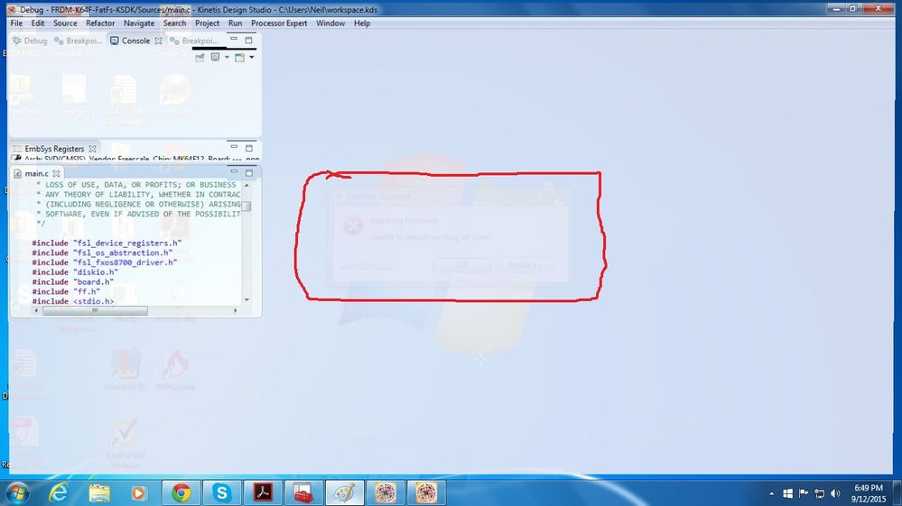

Hi everyone,

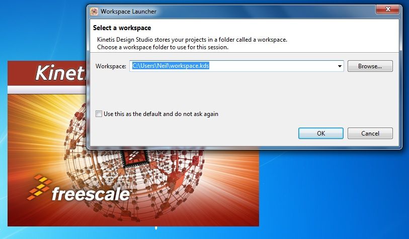

I starting this discussion because I have been noticing this window that appears when the IDE is starting.
First let me show you the window that appears before the error (this is normal behavior)
Now, once I click on OK the following window shows.  Unfortunately its very light in the following picture
but, it actually shows clear and it last about 5 to 8 seconds, then it disappears after Kinetis loads up.
It reads,
Restoring Problems
Unable to restore to working set state
then it gives the option to hit OK or Details, but when you click on either one, the window reads not responding.
Do I have to re-install the Kinetis 3.0 or is there a fix/patch to this issue?

Hi Neil,
it seems to me that your workspace settings have a problem (with the working set settings). Can you try using a new/fresh workspace?
If this solves your problem, then you can import your projects into that new workspace.
I hope this helps,
Erich

neilporven
Senior Contributor I
Hi Erich,
So, I thought it was an issue with KDS 3.0, so I downloaded it again and did a repair.  It
didn't take care of the issue, so I tried what you recommended and it did the trick (fixed).
I also was able to import the project into that new workspace and test it.  Now, I am not
getting this error.  I am not sure how the original workspace got corrupted, but I am not
about to start an investigation as to why.
