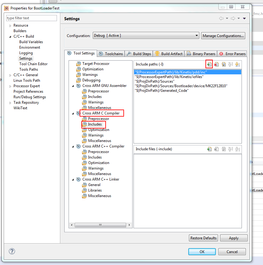

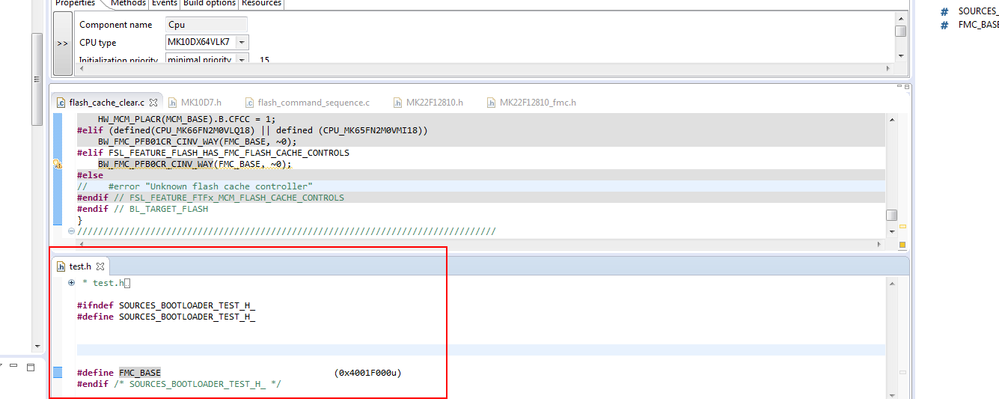

Hello Roger,
Maybe the reason of structure of the header file .
(1) I create a now header file "test.h" , then copy that macro to it , then build , there will be have not this error.
(2) Please add all the header file paths here :
Alice
