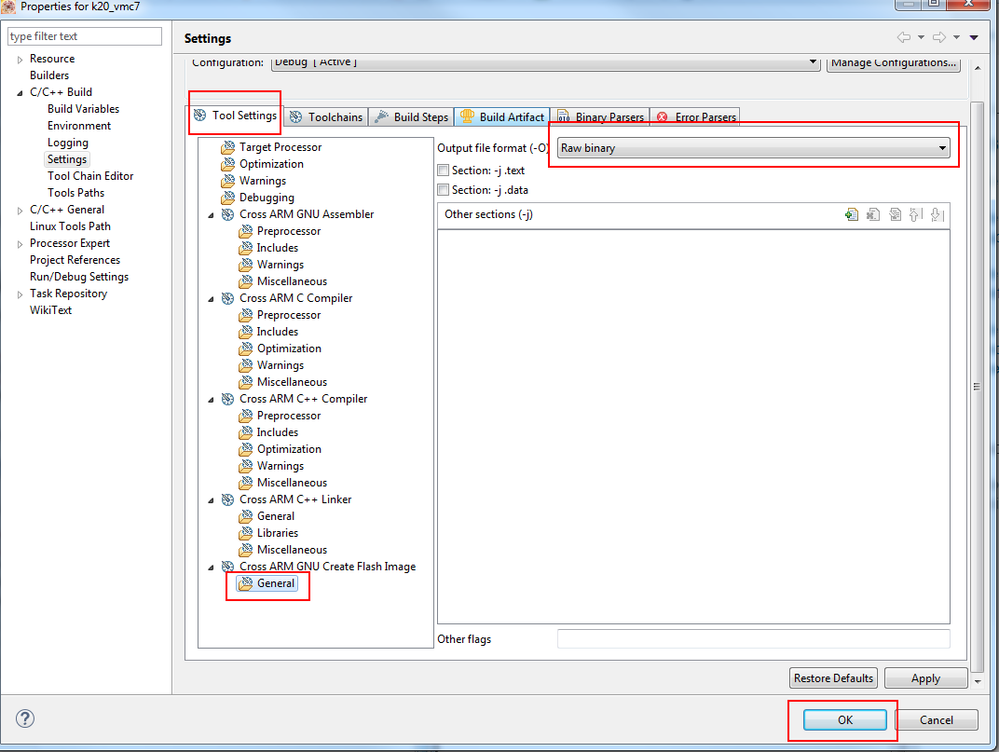

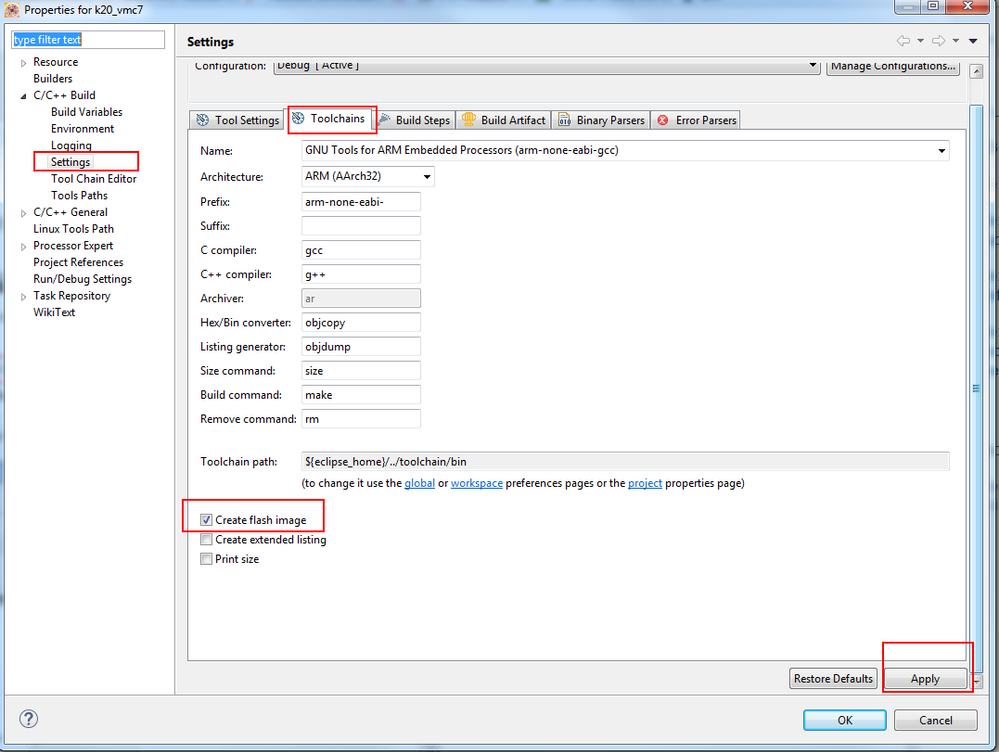

Hello Christis ,
(1)  From the Kinetis Bootloader v1.2.0 Release Notes.pdf , we can see that KBOOT v1.2  can  compile on KDS 3.0 .
(2) On KDS 3.0, please configure here to generate .bin file :
then build , you find the .bin file under the debug file .
Hope it helps
