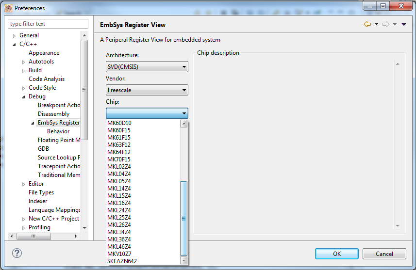

Is there a way to view the K65 registers in KDS in the way CodeWarrior does it?

Hi Erich,
I don't see the K65 in the list.

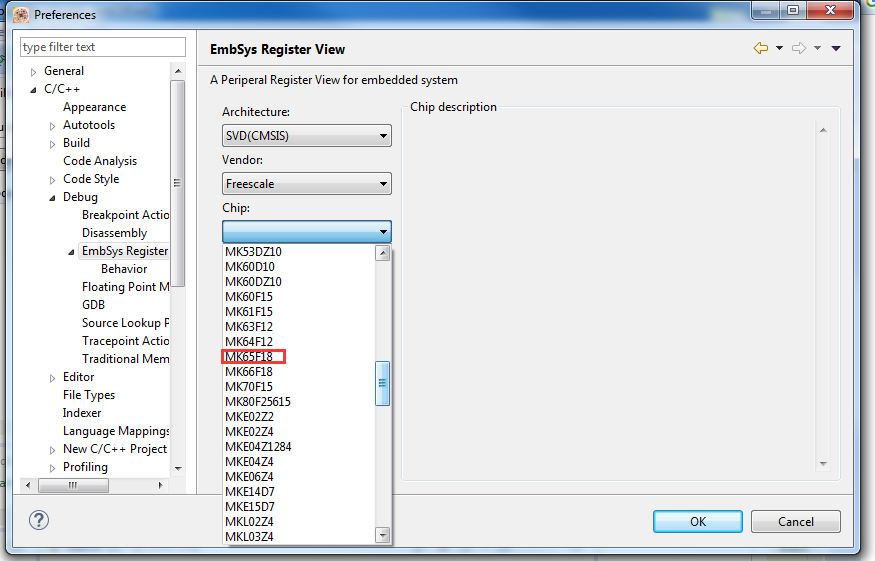

Hello Michael,
-I think at this time you maybe can not create project about K65.
Please first download  and install the "KSDK_1.3_TWR-K65F180M" ,
download please refer to this thread : How to: install KSDK 2.0 ;
install it to KDS please refer to the DOC under KDS installation directory :KDS_3.0.0\doc\KDS_Users_Guide.pdf
- Then you can see this chip :
Hope it helps
