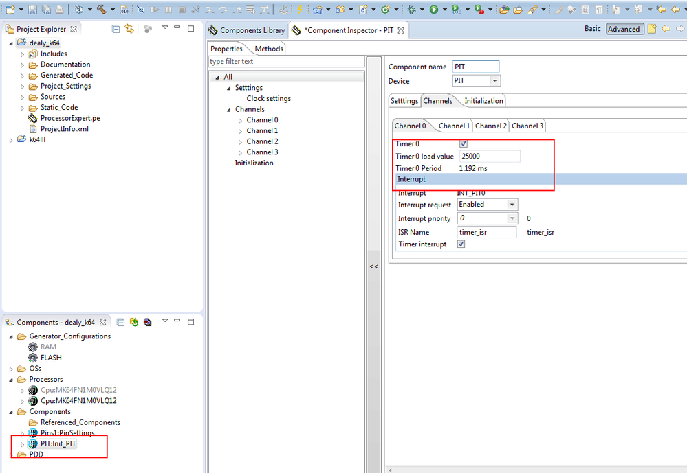

Hello people, recently i bought a K64F Board and i am kind of new to embedded programming scene , can somebody point me to a direction where i can learn to set which oscillator to use to set the clock speed then write a simple ms delay function. Thanks a lot (I am using KDS and avoiding to use PE and other similar programs to learn from the scratch)

Hello Dogus,
There is no bare board demo delay function .
- About the clock , you can first read the CLOCK chapter of the Reference manual ,
then you can only create one simple project on KDS, then you can see the different clock mode
about how to configure the related registers :
- About the delay function , you can configure the PIT timer by your self , also i think the simple
method is you create one PE project, then configure the  interrupt :
Hope it helps
