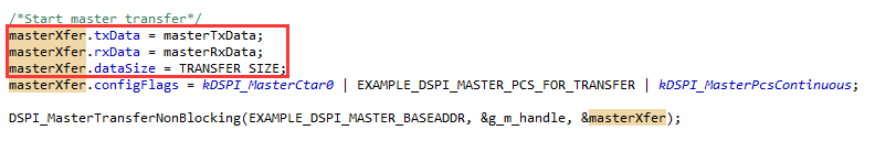

The function of  "DSPI_MasterTransferNonBlocking()" can used as both receive and send .
The butter and size is configured in a structure like the demo :
If you want send one byte ,  set the dataSize to 1 : slaveXfer.dataSize =1;
Hope it helps
Alice
