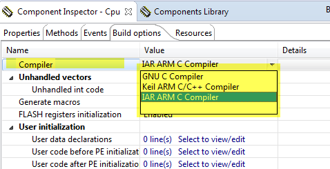

I have started a KDS Processor Expert project and imported a component settings file from another project.
When I compile, I get the following error message:
/Users/gerrykurz/Dropbox/Apparata/500Rack Design/Arm Firmware/V1-2/Rack_500/Generated_Code/PE_Types.h:66:24: fatal error: intrinsics.h: No such file or directory  #include <intrinsics.h>                         ^
Any idea how to fix this?

Hi, thanks for your responses. I am attempting to migrate a project from  IAR to KDS. I realize that I cannot do this directly, so what  I was attempting to do was to export only the  components from Processor Expert. Somehow the export is still linked to the IAR compiler even though when I went through the Processor Expert properties, I could not fine a  link or setup parameter to a compiler. Do you know how I can export just the processor expert components to a new KDS project without this link to the previous IAR project?

the the response from Jennie: you need to change the compiler setting to GNU C Compiler in the CPU component and then re-generate the code with Processor Expert.
I hope this helps,
Erich

There are several build tool chain selections in KDS processor expert
KDS uses GNU C Compiler, if we choose other compiler, we may see error as you have.
For detail method of fix, please see attached video.

Hi Gerry,
has this project be generated for the compiler (GNU gcc?) you are using, or for a different toolchain (e.g. IAR or Keil?).
I ask because there should be no such include in PE_Types.h if that project is for GNU ARM gcc (checked quickly on my side).
The <intrinsics.h> is a header file provided with the libraries (for your toolchain/compiler) and contains 'low level compiler' things like special way to generate assembly instruction sequences and similar things. It is very compiler specific.
Apart from that, if you indeed have that and need that, it has to be found within the compiler search path settings (-I compiler option).
So can you verify that this project is indeed for GNU ARM gcc compiler?
