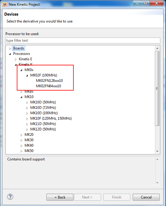

I have friends that have the K02 processors on their new project start uo lists. I am running the same KDS and I just did the SDK update.. But my new project processor list starts with the K10 line up. How can I get the K02P6 processors to be supported on my KDS installation?

Hello Rande Newberry ,
I know your problem ,  you have still missing one step.
After you install the KSDK1.3, please  update it in the kds  refer to the DOC"KDS_Users_Guide.pdf" ( the doc under :
reescale\KDS_3.0.0\doc ) - > 4.2 Installing Kinetis SDK into KDS .  then you when you create project , you can see the chip k02 .

Hello Rande,
Which version of KSDK do you installed ?Please install the latest KSDK 1.3 .
And what about the whole part number of your chip.
In my side , kds3.0 , ksdk1.3 :
Hope it helps
Alice
Alice Yang
3,392 Views
randenewberry
Hi Alice,
Sorry for the late confirmation, that worked, I missed that in the Manual.

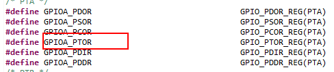

I am struggling with the SDK. I've got single pin port pin setups ok,
but do not see how to set up a nibble or byte wide port.
Can you point me in the correct direction?

Hello Rande,
Sorry for i don't understand what's mean about "single pin port pin" , could you please describe it in detail, thank !

Hi Alice,
I used the fsl_gpio component in processor expert to configure
individual processor ports (I call them Pins). Then using the
fsl_gpio_driver.h file as a reference, I created the necessary C code to
name and be able to read the port pin (i.e. either 1 or 0) or write the
port pin (i.e. either 1 or 0).
I do not see where I can combine port pins into a nibble or a Byte or a
word.
In other words I want to read a Byte on port C0 - C7, but I do not see
where I can combine these individual port pins (C0 - C7) into an "8 bit
port" that I can read (i.e. read port C_byte, and return 0xF5 for example).
Any help would be greatly appreciated.

Hello Rande,
- For example , writhe all of the PTA ports , you can use "GPIOA_PTOR ",
GPIOA_PTOR  = 0x00000001;  // this meaning only the PTA0 output "1" , PTA1-PTA31 output "0"
Other registers is the same use , you can find the related file here :
Freescale\KSDK_1.3.0\platform\devices\MK02F12810\include\MK02F12810.h
Hope it helps
Alice
