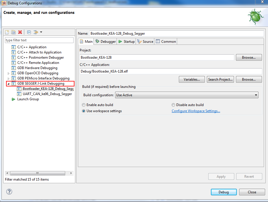

I am trying to program a MKL25Z128xxx4 using a J-Link but I ran into a problem. The error states:
     Plug-in ilg.gnuarmeclipse.debug.gdbjtag.jlink was unable to load class      ilg.gnuarmeclipse.debug.gdbjtag.jlink.dsf.LaunchConfigurationDelegate.
     ilg/gnuarmeclipse/debug/gdbjtag/dsf/AbstractGnuArmLaunchConfigurationDelegate
I'm not sure what this issue is. For the project in KDS, I have set the project to create a flash image in Project Properties-> C/C++ Build ->Settings -> Toolchains.
Could someone provide some insight on this issue? Please let me know if I need more information as I don't know what the cause of this problem is.

Hello Thanh,
- Please be sure the hardware is  connected well , be sure the PC have detect the J-link .
-In the Debug Configurations , please select the J-link debugging :
- Please first create one simple project to have a try  .
If still can not work ,please take a screenshot about the steps you do , especially the debug configurations ,
the "Main" and "Debugger":
Hope it helps
Alice

BlackNight
Does it work for other project and is it just this project which fails? Can you try with other projects (created by the wizard)?
Otherwise I think you have updated your GNU ARM Eclipse plugins and corrupted them somewhow. I recommend that you get KDS V3.2.0 installed (you can install it side-by-side, so no need to uninstall your current 3.0.0).
I hope this helps,
Erich
