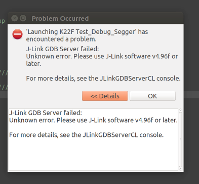

I'm getting an error when trying to debug using Segger J-Link OpenSDA firmware on a FRDM-K22F. The message is:
But — I am running KDS 3.1.0 and the debug console itself reports v4.98b. The firmware on the FRDM board is JLink_OpenSDA_V2_1_2015-10-13.bin.

/opt/Freescale/KDS_v3/segger/JLinkGDBServerCL -if swd -device MK22FN512xxx10 -endian little -speed 1000 -port 2331 -swoport 2332 -telnetport 2333 -vd -ir -localhostonly 1 -singlerun -strict -timeout 0
SEGGER J-Link GDB Server V5.10n Command Line Version
JLinkARM.dll V5.10n (DLL compiled Feb 19 2016 18:45:10)
-----GDB Server start settings-----
GDBInit file: none
GDB Server Listening port: 2331
SWO raw output listening port: 2332
Terminal I/O port: 2333
Accept remote connection: localhost only
Generate logfile: off
Verify download: on
Init regs on start: on
Silent mode: off
Single run mode: on
Target connection timeout: 0 ms
------J-Link related settings------
J-Link Host interface: USB
J-Link script: none
J-Link settings file: none
------Target related settings------
Target device: MK22FN512xxx10
Target interface: SWD
Target interface speed: 1000kHz
Target endian: little
Connecting to J-Link...
Segmentation fault (core dumped)

This looks like a real bug in Segger's software. How do I report this other than posting here?

Eric, thanks for your help.
Unfortunately, there were no zombie processes, restarting the machine did not help. I updated Segger J-Link to the latest version, but the message remains the same. I also launched the actual debugger command manually, to see for myself what was happening and:

My guess is that the message is incorrect.
I'm puzzled — this whole setup has worked for me in a number of scenarios, with various FRDM boards. I recently used it to program a FRDM-KL03Z, FRDM-K20, and also my own boards that use a KL03, using a real Segger J-Link device. Earlier on I also used the same environment with a FRDM-KL05Z and FRDM-KL25Z. It's just with the K22F that I'm seeing these problems.
To test and confirm, just after getting the above segfault I connected a FRDM-KL03Z and successfully loaded & debugged an application using the J-Link OpenSDA interface.
Is there a certain combination of firmware that I should be using? What do people use to develop on the FRDM-K22F? It's my first time with this board and so far I found no way of reliably programming it. Segger coredumps, P&E works but is flaky — it sometimes disconnects and loses the device.
Should I be using something different than JLink_OpenSDA_V2_1_2015-10-13.bin? I admit I'm getting lost in all the combinations of OpenSDA, mbed, JLink and P&E…

I see that you are using MK22FN128xxx10 and not MK22FN512xxx10?
Yes, I noticed that right after posting. But this makes no difference (I tried).
I envy your results. I wish I was getting this output :-)
Some more checking shows that:
  • starting GDB without the board attached does produce the correct messages:
Connecting to J-Link failed. Connected correctly?
GDBServer will be closed...
Shutting down...
Could not connect to J-Link.
Please check power, connection and settings.
  • connecting my board produces:
  • strace of the gdb process shows it successfully connects to the USB device in /dev, reads 139 bytes, and a while later segfaults.
This seems to be a bug and not something I can fix. No developing on the FRDM-K22F for me, I guess.
5,259 Views
jrychter
Contributor V
I forgot to summarize:
  • Segger OpenSDA firmware causes gdb to core dump and doesn't work at all,
  • PEMicro firmware works, but is flaky, and sometimes disconnects and can't find the device anymore,
  • OpenOCD isn't usable either:
/opt/Freescale/KDS_3.0.0/eclipse/../openocd/bin/openocd: error while loading shared libraries: libudev.so.0: cannot open shared object file: No such file or directory
Which means the board is pretty much unusable. I managed to "fix" OpenOCD by symlinking libudev.so.1 to libudev.so.0 (not sure if this is reliable) and it works, but is very slow compared to J-Link.
I'm slightly puzzled: I can't be the only one trying to use this board? Am I the only one using Linux and FRDM-K22F?

So, several months later, I tried again, this time also with a newer OpenSDA J-Link firmware (2016-09-16 with md5 6d934842d957831cbe90b426712dcac3). No success.
I can use the FRDM-K22F with PE firmware (it's painfully slow, and has issues, but kind of works), I can use a standalone J-Link, I can use FRDM-KL03Z with J-Link firmware, but trying to use FRDM-K22F with J-Link firmware fails with a segfault and a cryptic error message.
Has anyone succesfully used a FRDM-K22F with J-Link OpenSDA firmware under Linux? It seems this simply does not work.
