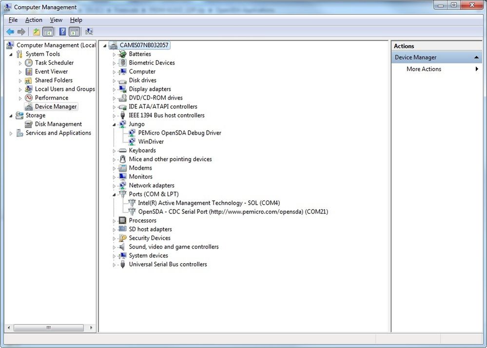

I've verfied that the USB drivers for the PE micro openSDA debugger are present in device manager:

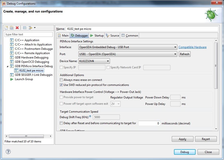

Here is the debug configuration I setup:

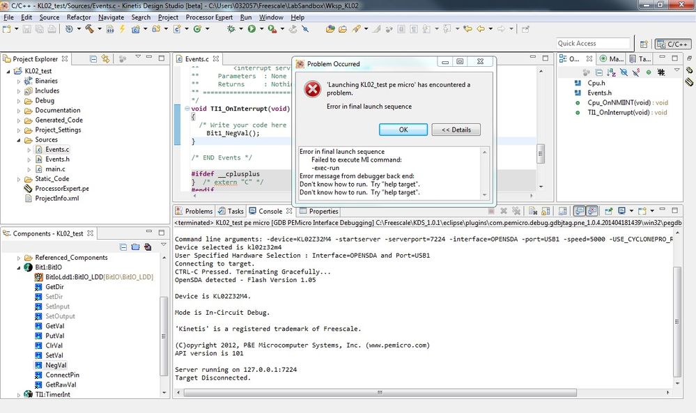

When i hit the debug button i get the following error message:
Any idea what this error message means?

not sure if this matters, but:
P&E has an updated debug app (MSD-DEBUG-FRDM-KE02Z_Pemicro_v114.sda), available from https://www.pemicro.com/opensda/.
At least this is what I'm using.
And with this I can debug my board. Your settings in the screenshots looks good to.
Just in case, I have attached my project. Note that I had to increase the heap size in the linker file because the newlib-nano needs that.
Can you try this?
I hope this helps,
Erich

By the same token of lateral pertinency  :smileyhappy:, it may help to remember that in version 1.1.1 of KDS in the pemicro\opensda folder under the KDS 1.1.1 installation folder it can be found all the updates for SDA from P&E.
HTH
Cesar Rabak
