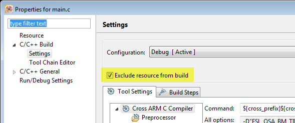

Is there a way to restore a file to the build if it has been previously excluded in KDS 3.0? It appears that the capability has been removed.

right click on the file and uncheck 'Exclude resource from build':
