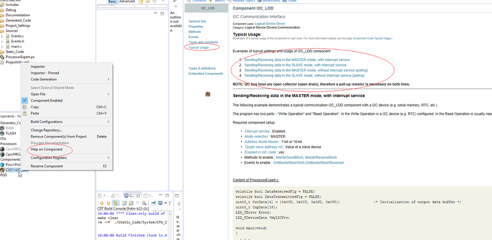

Hello Christopher ,
 Could you please share your code ?
The function of SendBlock() includes whether send stop signal :
Also there is typical usage about the I2C_LDD component , you can have a look :
Right click I2C component -> Help on component -> Typical Usage :
TIC
