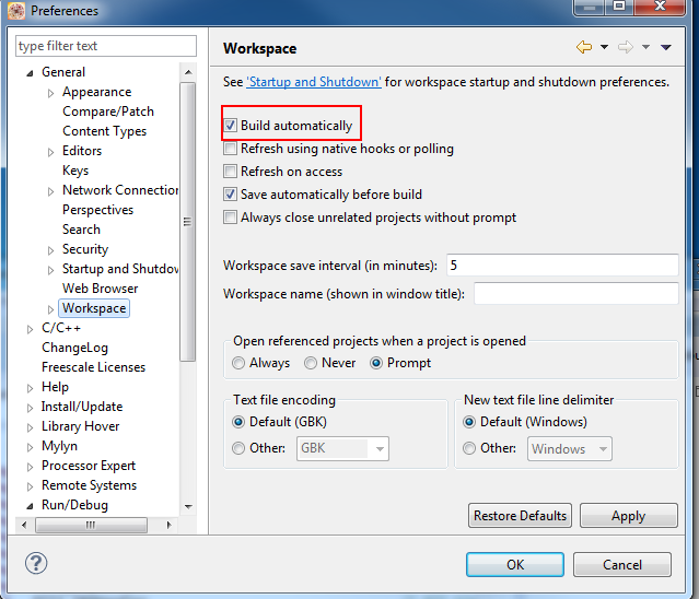

Hello Sam,
In KDS ,The Workbench will automatically perform incremental builds of resources modified since the last build. Whenever a resource is modified, another incremental build occurs.
Please pay attention to the "Build automatically" is slect (see the screenshot).
Best Regards
Alice

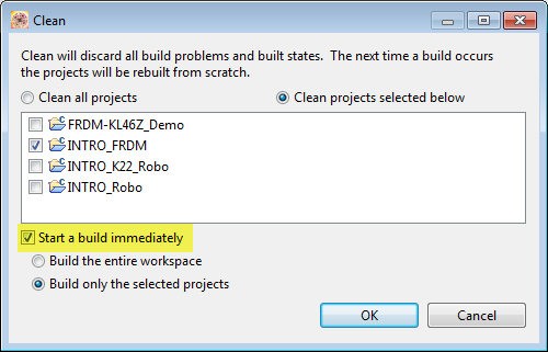

BlackNight
You can do a clean+build with the menu Project > Clean dialog:
2,650件の閲覧回数
ZhangJennie
oh, i know. I didn't see "Start a build immediately" because i have "project", "build automatically" enabled in my KDS. we need make sure we didn't select "build automatically" we can see exact window as Erich shows .
Best Regards.
Zhang Jun
