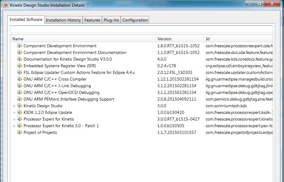

This is my KDS Installation

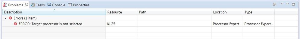

FRDM-KL25Z
Project build:
  1. Device page: processor to be used Board,
    FRDM-KL25Z
  2. Rapid Application Page: KSDK-none,
    PE-selected
Generates following error:

Hi Shaul,
the error message "Target processor is not selected" is a bug of the wizard if you select a non-SDK project with Processor Expert, and if you select a board (e.g. FRDM-KL25Z) instead of the microcontroller (KL25Z128M). This should have been fixed with an update, or simple create the project with the microcontroller on it selected, instead of the board name.

If you take a look on my “Installation details” you can see that there is “Processor Expert Patch 1”.
This patch doesn’t solve the wizard bug.
Yes I create the project with the microcontroller instead the board and it is working.
My question is  if it is equivalent to board installation?
I thought that board installation is supporting all the board hardware and processor is supporting only the controller.
1,557 Views
BlackNight
Hi Shaul,
yes, indeed, I have that patch installed too, but still have that issue. I thought it had been fixed, but it looks I was wrong about that.
The difference between the 'microcontroller' or the 'board' version: in the board version the pin muxing in the PinSettings component of the project is already set up to wire up the components of the board (e.g. LED, etc). So the pins already have the correct names. Apart of that, no difference.
