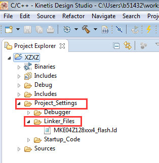

Hello Danyon,
Could you please send your project to me ?
If your project is made on KDS, it automatic has the linker file :
Hope it helps
Alice

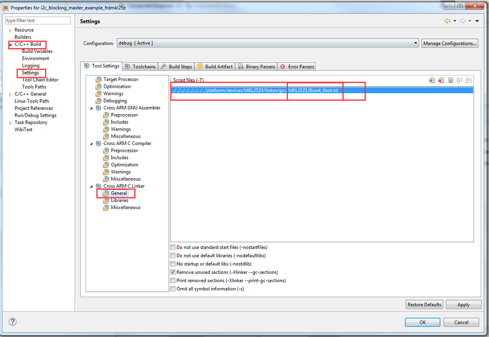

Hello Danyon,
Please right click your project, then select "Properties", then you can find the linker file path:
Hope it helps
TIC
12,384 Views
danyonchu

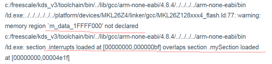

Error code:
make -k -j4 all
Building target: Display_slave_MKL26Z128VLH4.elf
Invoking: Cross ARM C Linker
arm-none-eabi-gcc -mcpu=cortex-m0plus -mthumb -Os -fmessage-length=0 -fsigned-char -ffunction-sections -fdata-sections -Wall -g -T ../../../../../../platform/devices/MKL26Z4/linker/gcc/MKL26Z128xxx4_flash.ld -Xlinker --gc-sections -Wl,-Map,"Display_slave_MKL26Z128VLH4.map" -Xlinker -z -Xlinker muldefs --specs=nano.specs -Wall -fno-common -ffunction-sections -fdata-sections -ffreestanding -fno-builtin -Os -mapcs -Xlinker -static -o "Display_slave_MKL26Z128VLH4.elf" -Xlinker --start-group ./utilities/fsl_debug_console.o ./utilities/print_scan.o ./startup/startup.o ./startup/startup_MKL26Z4.o ./startup/system_MKL26Z4.o ./sources/fsl_i2c_irq.o ./sources/main.o ./board/board.o ./board/gpio_pins.o ./board/hardware_init.o ./board/pin_mux.o ../../../../../../lib/ksdk_platform_lib/kds/KL26Z4/debug/libksdk_platform.a -lm -lg -lgcc -lnosys -Xlinker --end-group
c:/freescale/kds_v3/toolchain/bin/../lib/gcc/arm-none-eabi/4.8.4/../../../../arm-none-eabi/bin/ld.exe:../../../../../../platform/devices/MKL26Z4/linker/gcc/MKL26Z128xxx4_flash.ld:77: warning: memory region `m_data_1FFFF000' not declared
c:/freescale/kds_v3/toolchain/bin/../lib/gcc/arm-none-eabi/4.8.4/../../../../arm-none-eabi/bin/ld.exe: section .interrupts loaded at [00000000,000000bf] overlaps section .mySection loaded at [00000000,00004e1f]
collect2.exe: error: ld returned 1 exit status
make: *** [Display_slave_MKL26Z128VLH4.elf] Error 1
makefile:45: recipe for target 'Display_slave_MKL26Z128VLH4.elf' failed
make: Target 'all' not remade because of errors.

Hello Danyon,
Please check the two error message:
You can also send your whole project to me.
Alice

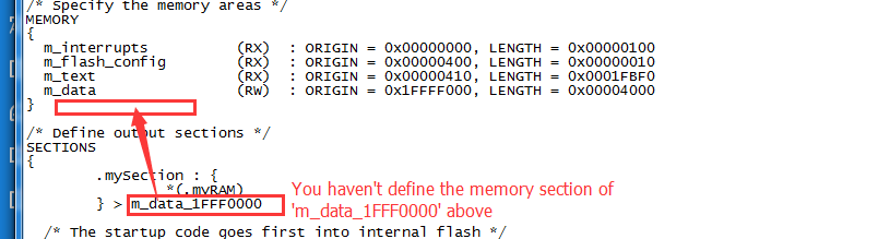

Hello Danyon,
1. You haven't send your  linker file .
2. In  your code  I haven't find the code about
__attribute__ ((section(".xxx"))) xxx;
The two points are mainly we need to check .
Alice

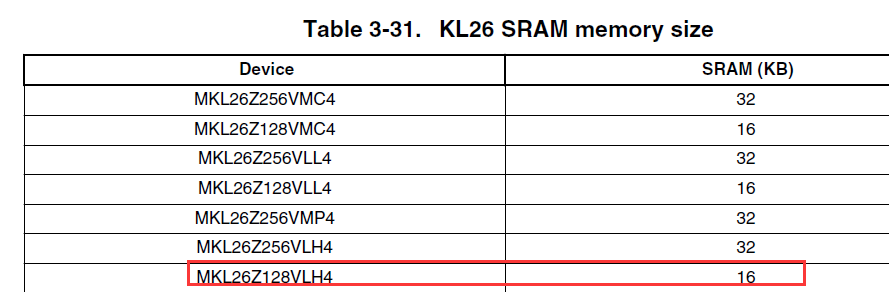

Hello Danyon,
1> The chip MKL26Z128VLH4 on FRDM-KL26 board only have 16K RAM,
So when configure #define IMG_LENGTH 20000 , it overflow. May be you can take place the array to
flash into account.
2> And the linker file you send me has a mistake :
Alice

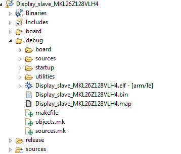

Hi Danyon,
Which .bin file do you copy ? How ?
The MKL26Z128 has 128K flash in total,  from the message we can see there is 384K about your file.
Alice

danyonchu
The .bin file that I copy is from the image below. I copy it by dragging it into the drive that appears when you connect the FRDM-KL26Z board through a USB port in the computer.
The only lines I changed in the linker file were:
/* Specify the memory areas */
MEMORY
  m_interrupts          (RX)  : ORIGIN = 0x00000000, LENGTH = 0x00000100
  m_flash_config        (RX)  : ORIGIN = 0x00000400, LENGTH = 0x00000010
  m_text                (RX)  : ORIGIN = 0x00000410, LENGTH = 0x0001FBF0
  m_data                (RW)  : ORIGIN = 0x1FFFF000, LENGTH = 0x00004000
 m_data_1FFF0000                (RW)  : ORIGIN = 0x1FFF0000, LENGTH = 0x00006000
/* Define output sections */
SECTIONS
 /*.mySection : {
  *(.myRAM)
 } > m_data_1FFF0000*/
this only declares a mem space of ~25KB. If these lines are removed, I can upload the code without an error to the FRDM board. What is going on? How can the code size be increased by at least 226KB to reach 384KB?

Hello Danyon,
1) What about this memory ?
Please check the SRAM ranges on Reference manual of your chip.
2) About the chip of " MKL26Z128VLH4", the largest internal FLASH is 128K , largest internal SRAM is 16KB.
Alice
